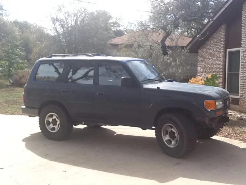

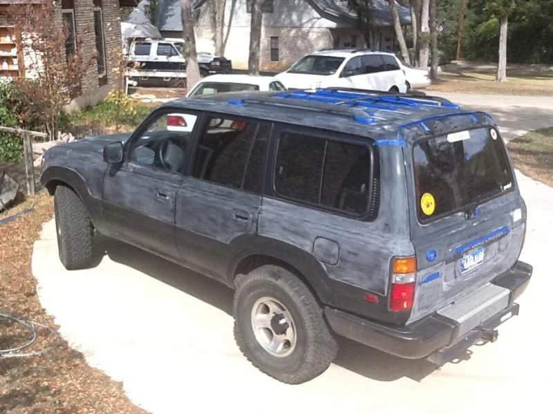

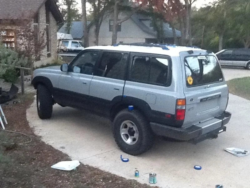

Rolled on some hardnose and whitecoat.
I used a 4in foam roller. 2 quarts on the body and 2 pints on the roof. I'll vet some pics after I wash it. I just back from doing some wheeling and it's dirty.

The bottom is Truck Bed Liner Kit #265GK:Truck Bed Liner | PlastiKote Paint Products I got it at walmart for $70 for the kit. When I saw it I thought why the hell not.
Yes, that is WHITECOTE-POR-15 Inc.

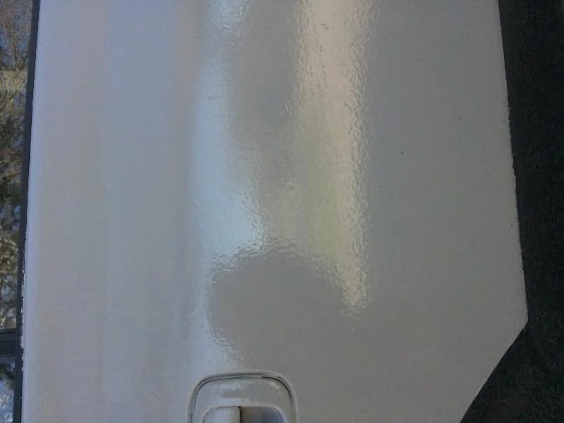

I asked about UV and they said it has UV protection in it, but we will see. It took my key after 3 weeks to see if I could scratch it and it did. We will see how it holds up to the brush.
I looked into the por-15 hard nose and it looks like good stuff, but sorry to heard it did not hold up to the key.
How many coats did you put on?
Got a photo of the key scratch?
Do you think it would go on smoother with less texture if you spread it on?

Yes, for the money I have in it. I thought it would come out darker based on the website. HARDNOSE PAINT-POR-15 Inc. I actually suspect that the paint was mislabled. Time will tell how it will hold up.
