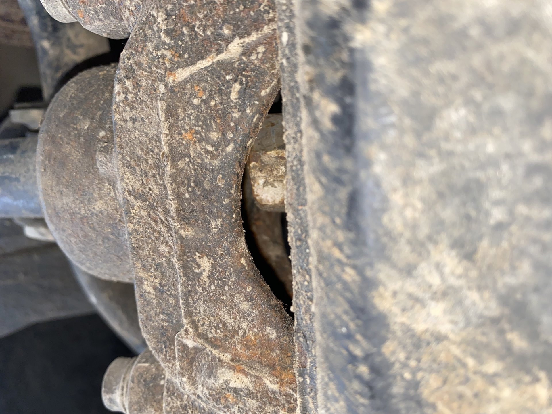

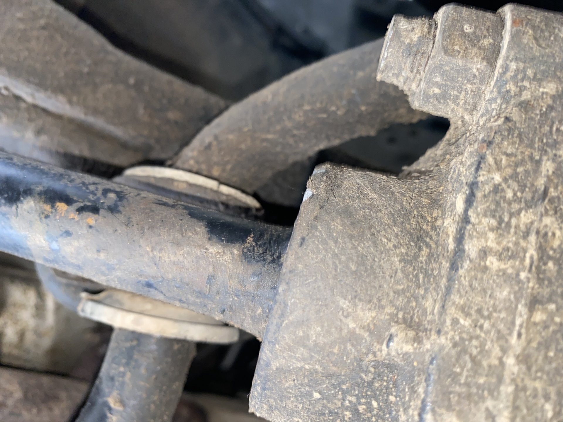

I continue to try to track this thing down. I may or may not have something. On the passenger side the torsion is all the way forward where it is touching the nut on the control arm. See first picture. This is not the case with the driver side where there is a gap. Wondering if anyone knows if this make a difference? The first two are the passenger, the second two are the driver showing how far the bar is inserted.

Check the torsion bar adjusters, and make sure they are assembled correctly. It does look like on of your TBs is in too far. Makes me wonder if the adjuster is out of whack. They are a bit tricky to keep aligned when initially tightening the adjuster.
But it sounds more like ball joints to me. Make sure everything is tight.
