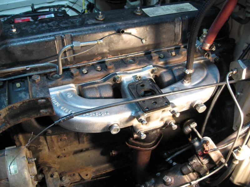

Very pretty parts now and hecka rewarding to beat the rust devil:clap:
Took the parts to Advanced Power Coating on Deming Way in Sparks, 3 pieces blasted cost $37.

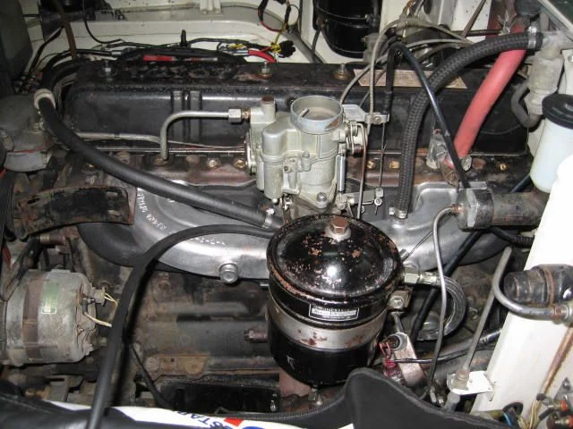

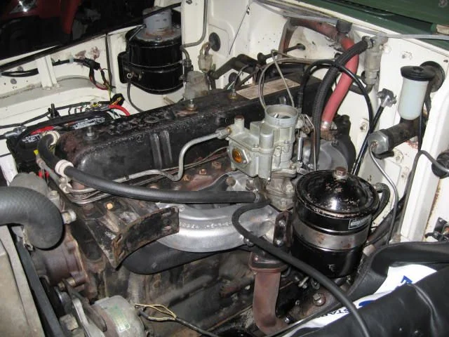

It's back together and it even runs! Ahhhh, the smell of burning grease, paint and what ever else I spilled during reassembly. :hillbilly:
So I got the Manifold and air intake back from the sandblaster and started priming and painting. The heat riser will have to be manually operated from now on as the spring and counter weight did not survive, but you can see the flapper is still intact and functioning.
Maybe you could find a good spring and couterweight off a Chevy six manifold. Toyota copied much of the older Chevy engine.

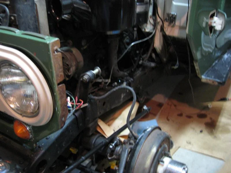

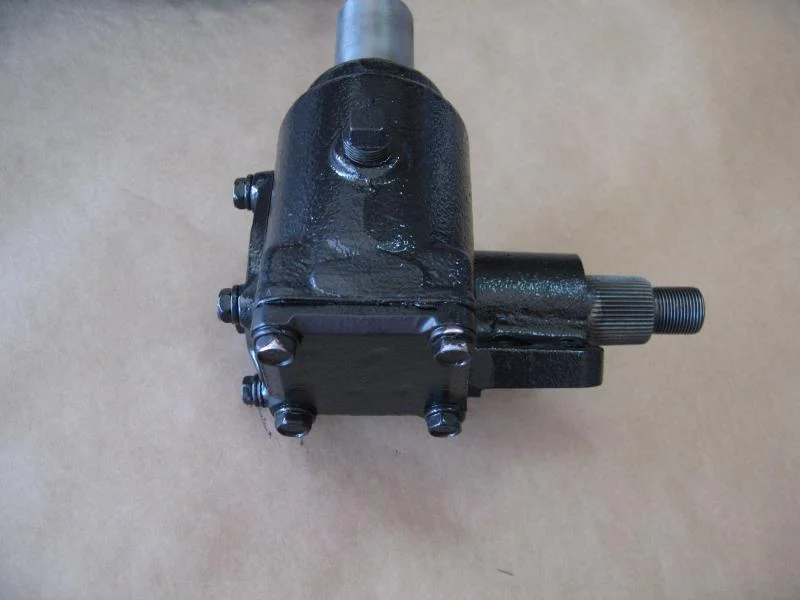

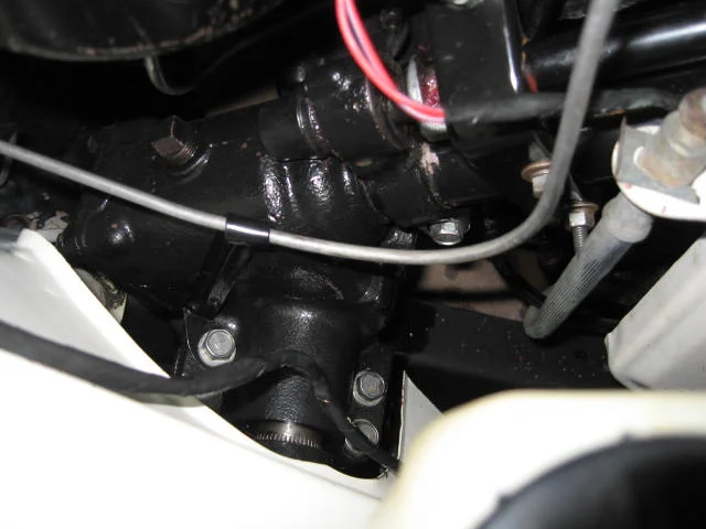

O.K., so I get the truck running and one last thing...replace the leaking gasket on the steering box, "Piece of Cake" right...not so much as the cover is the bearing race support and now the steering box is all jack'd up so...had to pull the whole thing out of the truck and rebuild the steering box and I found out why the turn signal detent isn't working as well.:bang:

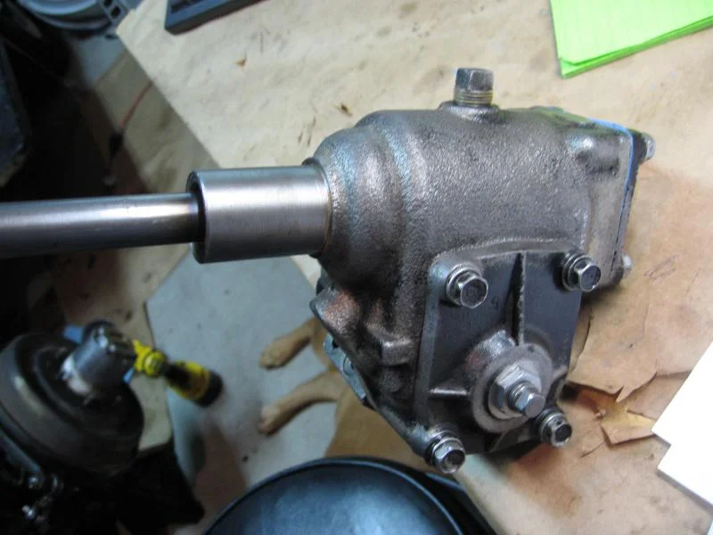

Got the steering box rebuilt-waiting on the sector shaft seal then I can reassemble the steering. Took 2 shims off the sector shaft to get the play out and the gear to mesh with the worm gear.
Don't forget some locktite on the pitman arm nut. I know it's a horizontal shaft, but I've seen 3 of them come loose this summer.
Yeah...those do have a tendency to come loose till they are totally seated. I had that issue on my 62 after I did the SOA. Had to constantly check that and tighten it down.
I thought for some reason using locktight was BAD for that!?
Donno why, but I heard that somewhere!
maybe for getting the thing off at a later date, or for it NOT seating all the way?

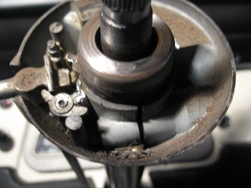

Steering is all back together, still a bit to tight but it works. Total pain in the A## trying to get the 3 on the tree and linkage to line up/mesh. This was a 4 :banana:even though the basic job seemed simple, because of the level of disassembly required. I almost think the upcoming clutch would be easier...? :hillbilly:
