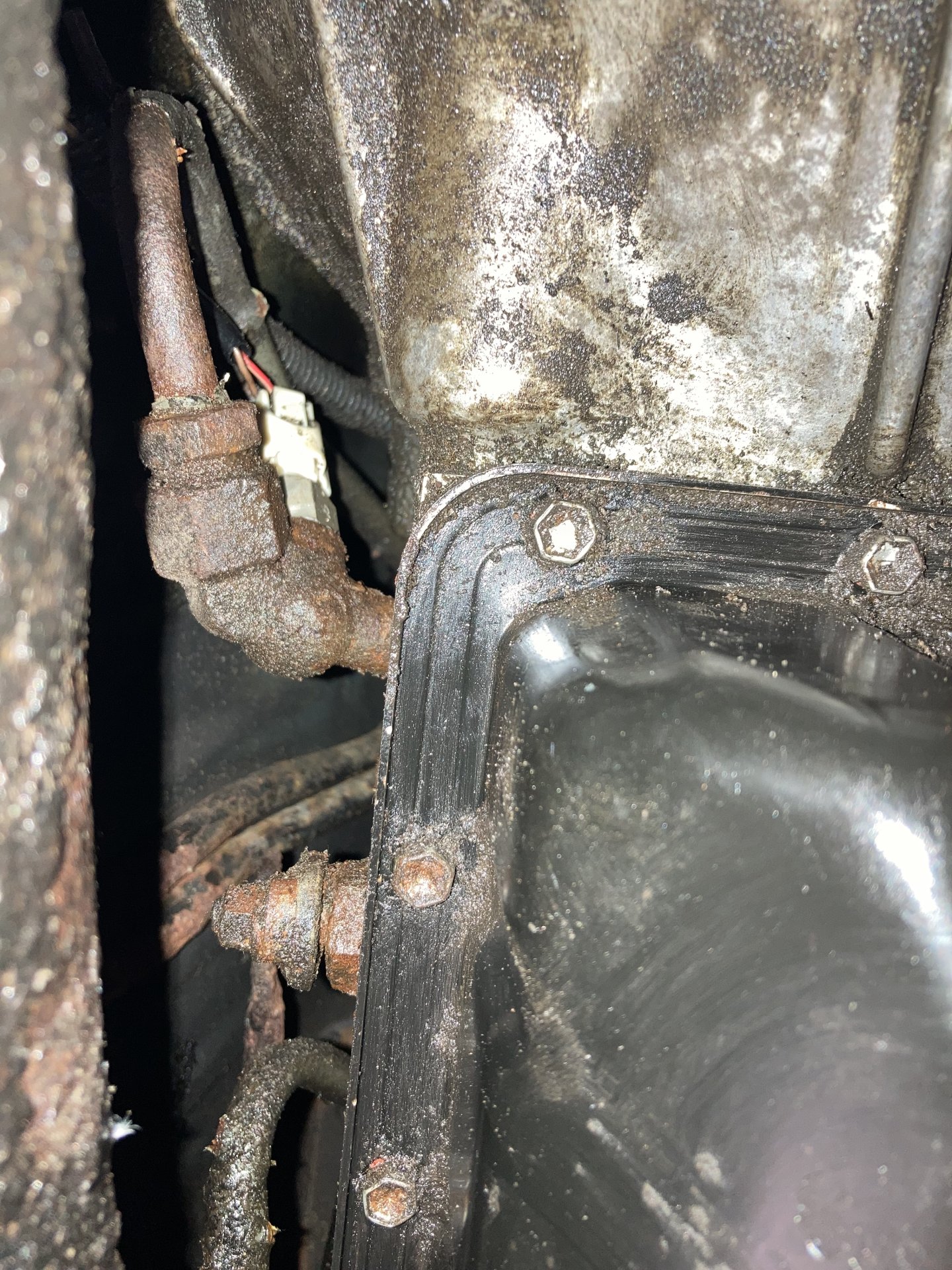

First step I figured was to replace the ATF temp sensor (part # posted below in pic). I couldn’t find a clear write up on this, so here goes.
The ATF temperature sensor is located just above the ATF pan, towards the front, on the passenger side. See pics. You can ID the sensor by the white plastic connector. It probably won’t look that way on your LC as it’ll be black with gunk. Needless to say, this is all accessed under the truck.
The ATF sensor doesn’t screw directly into the transmission, but rather screws into a hard ATF fluid line that comes out of the transmission just above the pan. It points up off the hard line and is a pain to get to.
After unplugging the wire harness from the sensor by pushing the clip in, I messed with a few different wrenches but there’s very little space to work. Eventually I decided to break off the plastic connector to be able to put a shallow 19mm ratchet head on it with a short handle ratchet. Took a lot of force to break it loose, but it did the trick. You don’t need to drain your ATF fluid to do this fix.
New sensor goes on easy. I cleaned the old female plug and connected them.
I cleared the code with an OBDII reader (you could also do it by taking off the negative battery cable for 10 minutes or so).
We’ll see if the light comes on again in 50-100 miles…
Hope this helps.
Happy wheeling,
Josh
