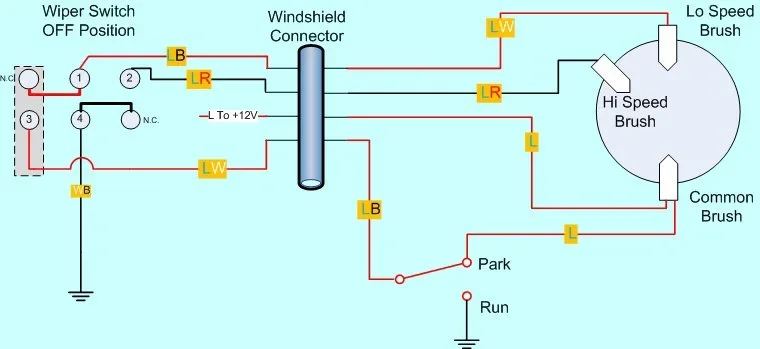

yes its hard to work out i changed from old window where wipers were above to an 84 window where there below and got working on low but nothing else even swapped switch but nothing:bang:
Hi FJ45350,
Here is a wire diagram for the windshield wiper motor that I finally found on my computer for you. There are different configurations so I hope this one helps you figure out your problems.
