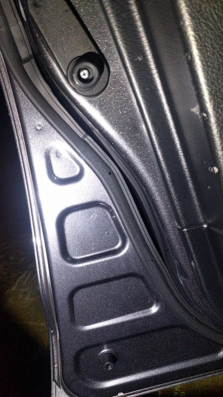

This curve on all four doors look like this:
Is this ok, or does it need attention?
On the 100, the LX had a few extra seals, are there additional seals I could add from an lx?
On my truck, the seal on the door fits tightly to the curve, unlike on yours where there appears to be gaps between the seal and the door. I don’t know if that makes a difference?

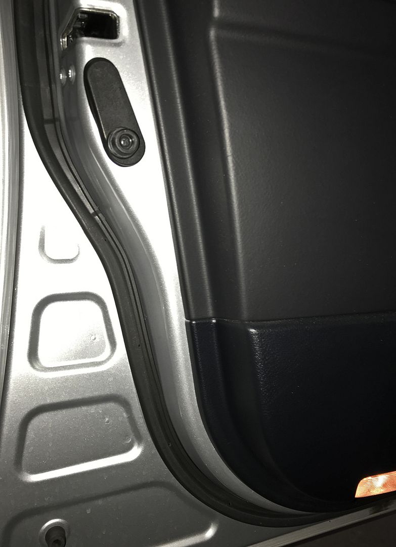

I think that seal is NOT OK. Here's mine (2013LC DS front door):
Comparing yours with mine, it looks to me like your door seal was replaced at some point in the past and not fit very well. Any history of an accident that involved your DS door?
In any event, I'd investigate properly fitting your door seal before investigating possible alternative seals (e.g. those used on the LX).

Thanks guys, I'm going to figure out how to get the door seals on that curve to hug better.
