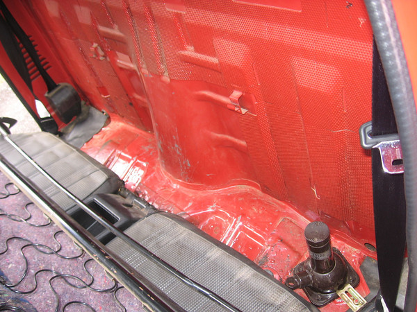

I've found what looks like an xlnt candidate but it's got some things I don't recognize. Like:
...Is this glass roving or whatever this surface material is, normal? It definitely isn't anything I remember from the period but I never looked this closely either.

I was told that bumpy stuff is just body insulation to help keep noise down. Its all over the back of my 83 and on the transmission tunnel. I havent bothered to look under the carpet of my '79 dd though to see if its the same
