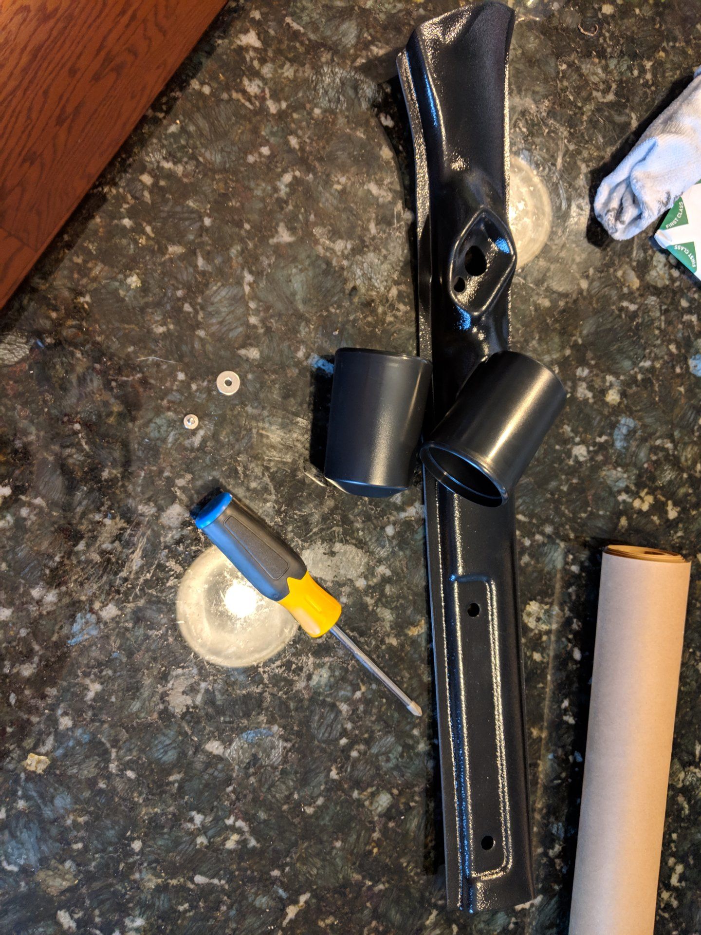

My pillar pod finally arrived, need to paint it white, but not bad for the money.

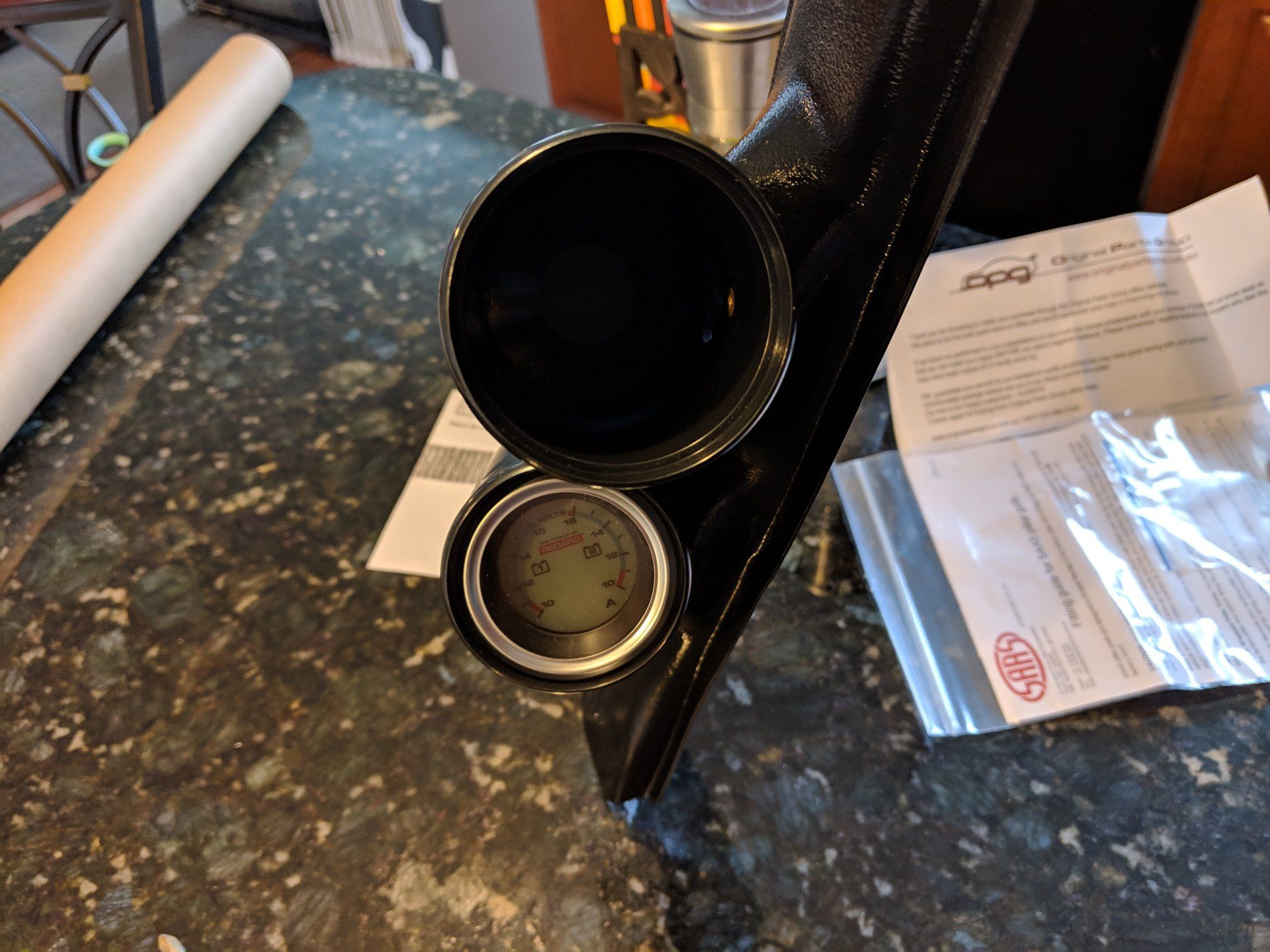

hey look at the timing, installed with one meter this weekend. Ill get pics when i get home. Havent wired the meter yet.

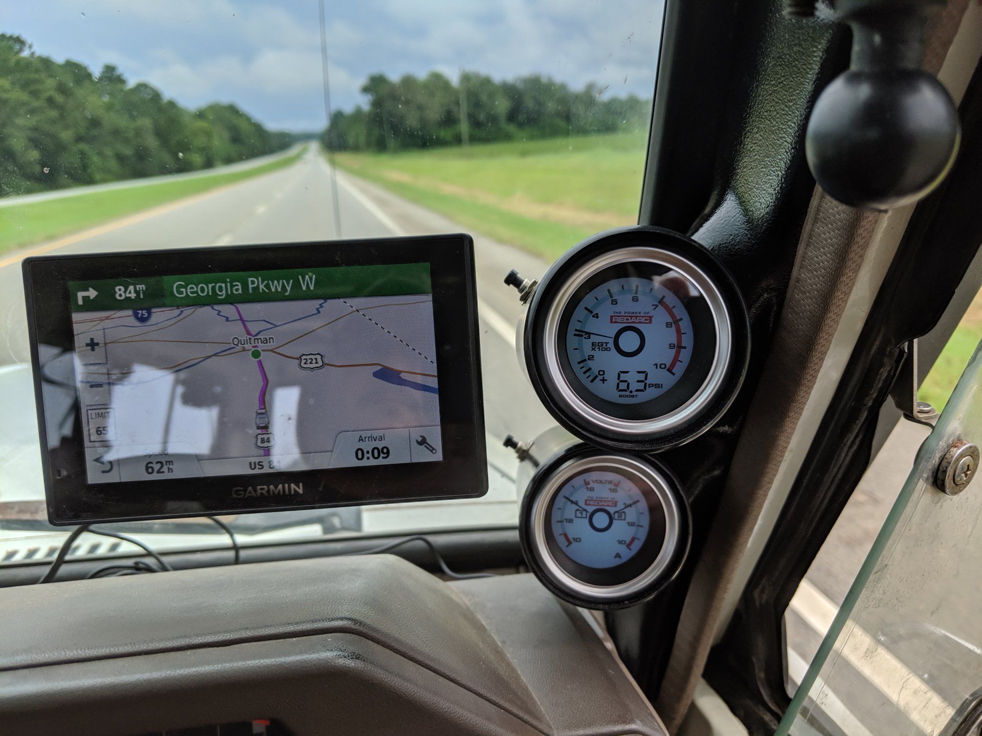

yea sorry, took a while. here is a pic on the way home yesterday from picking up the truck in GA after the turbo install

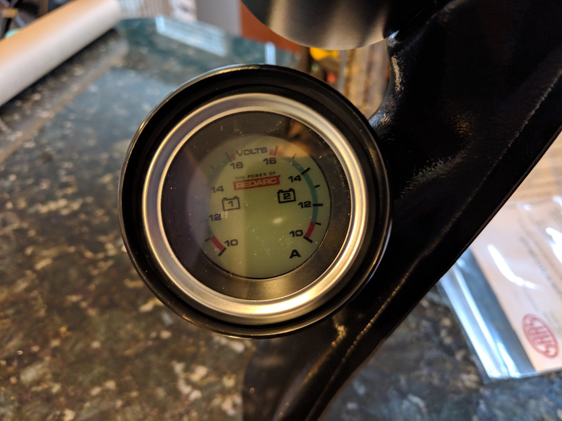

Your EGT is in Celsius? The gauges look nice. I just received my dual pod painted in grey and will mount it after I swap the dash pad. Do you find the dual voltage gauge useful? I have one gauge that has egts, boost and tranny temp, and a second gauge is afrs.
Yes, i really like the redarcs, no imperial yet, im used to metric so i dont mind. It is/will be. I have a bcdc1225 i will be installing, oving the house battery behind my seat, would be good to keep an eye on it.
What turbo did you end up installing? Your egt probe is preturbo?
Post turbo, cruising at 65 i rarely see 400, boosting 10.5 through the gears, if i really push it i can see 550. air to water intercooler keeps things cool. Garret turbo by odd iron, custom tuned

That’s nice but what does 1000f post turbo mean at preturbo? I thought the whole point of monitoring egts is to not melt your pistons. On my 1hd-t it’s 1250f preturbo that I don’t push past. I have a FMIC so even up hill at 20psi I only reach 1000f and it drops off very quickly when I take my foot off the throttle. I thought a tuning shop would understand that but maybe I’ve just been reading too much on mud.
