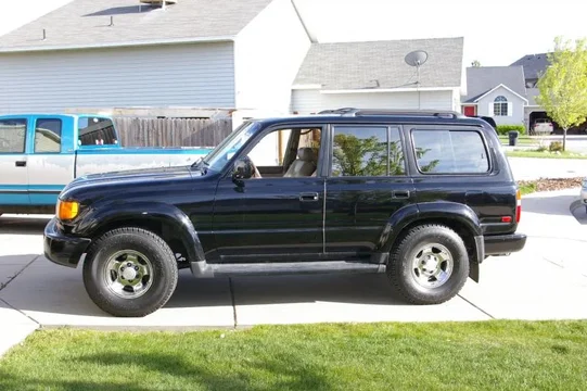

My 97 has the chrome wheels. I kinda like the look, but want to change them for blackies when I start wheeling more seriously.
