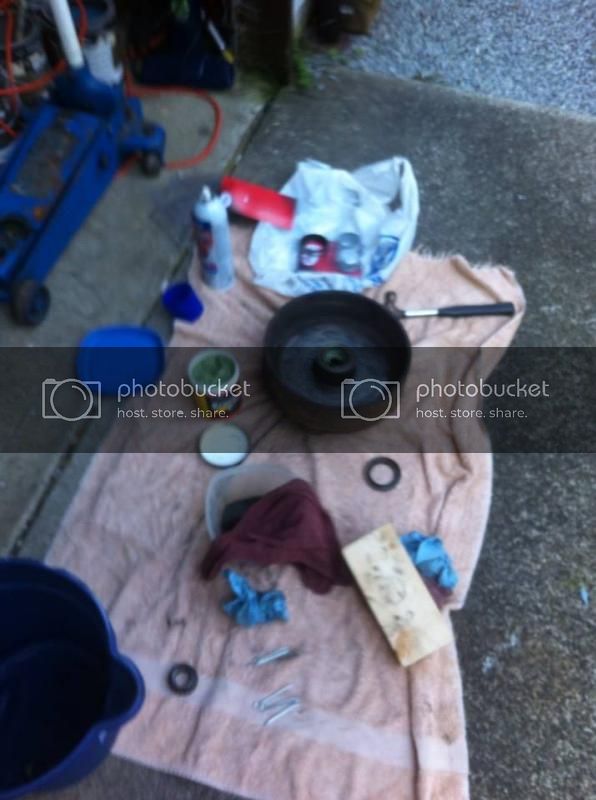

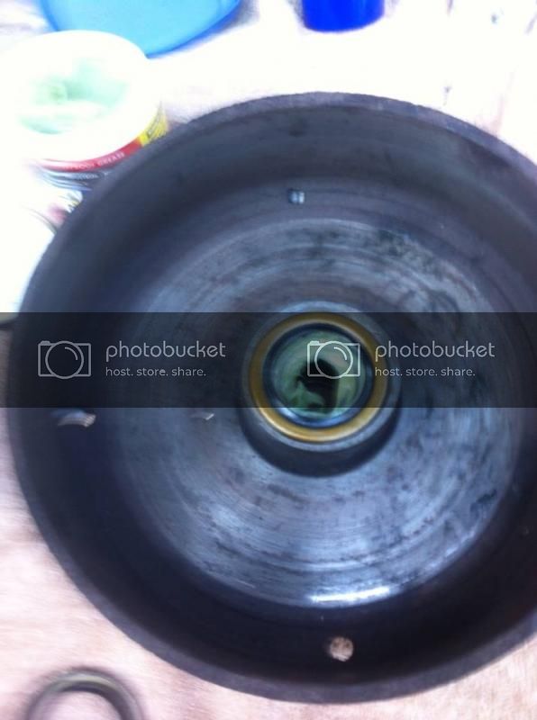

so far I pulled the wheels and hubs off and found that the bearing and races were almost new koyos except that some one had reused an old seal or put the wrong one in as grease had migrated past it and into the hub. So i repacked the bearing and put new grease seals in.

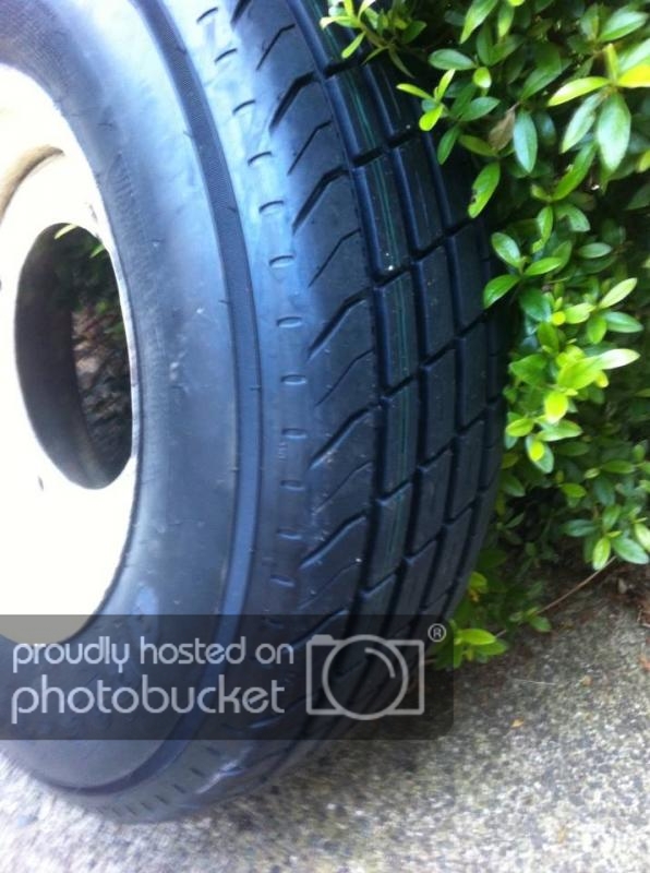

the tries were rotted and that size is no longer available (185/75r14 ST) , luckily for me I was able to get a set some 205/75r14 ST and it gives us a little more clearance

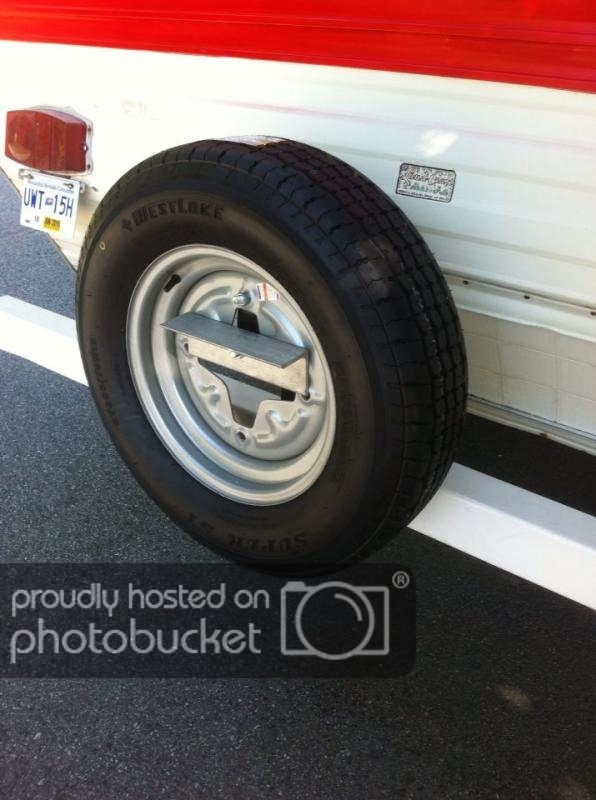

it has some weird assed rims (either the big circle or this star pattern which are very,very hard to find, and i was not about to do a road trip with out a spare, luckily i found a guy in chilliwack who had bought a brand new one in the states last year and traded in his trailer and kept the spare - it is useless to probably 99.99% of the other people except me so I paid him exactly what he wanted and thankfully after b.s.ing with him a few minutes he asked how I was going to mount it i told him we would head off to buy one from the rv shop and voila he pulled out his old mount ! sometimes it pays not to low ball someone !
