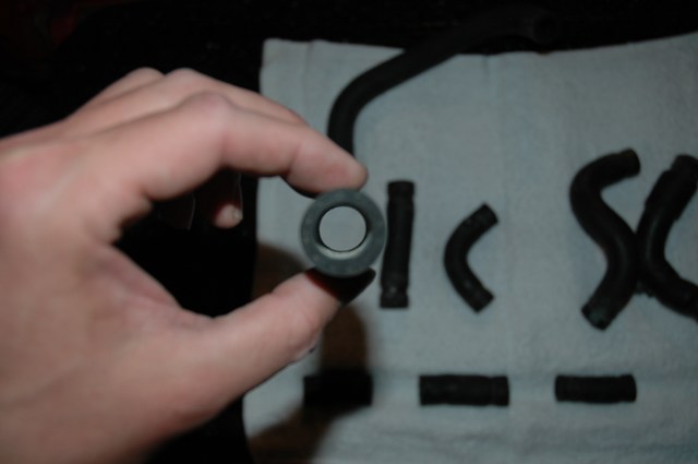

Bad news was I had 8 other heater hoses replaced (some swelling, some not) for a total of about 3 feet of green stripe Gates.
$105 not bad.

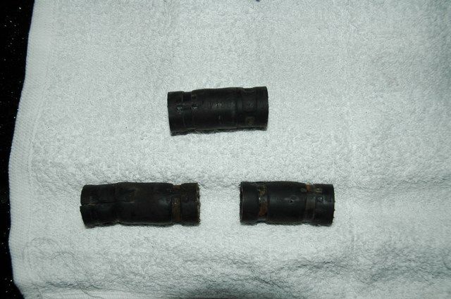

I took a few picks of my old PHH for the records.
