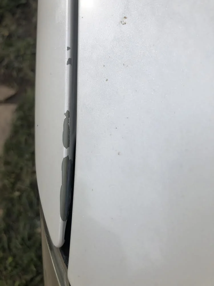

peeling / chipping blizzard pearl paint

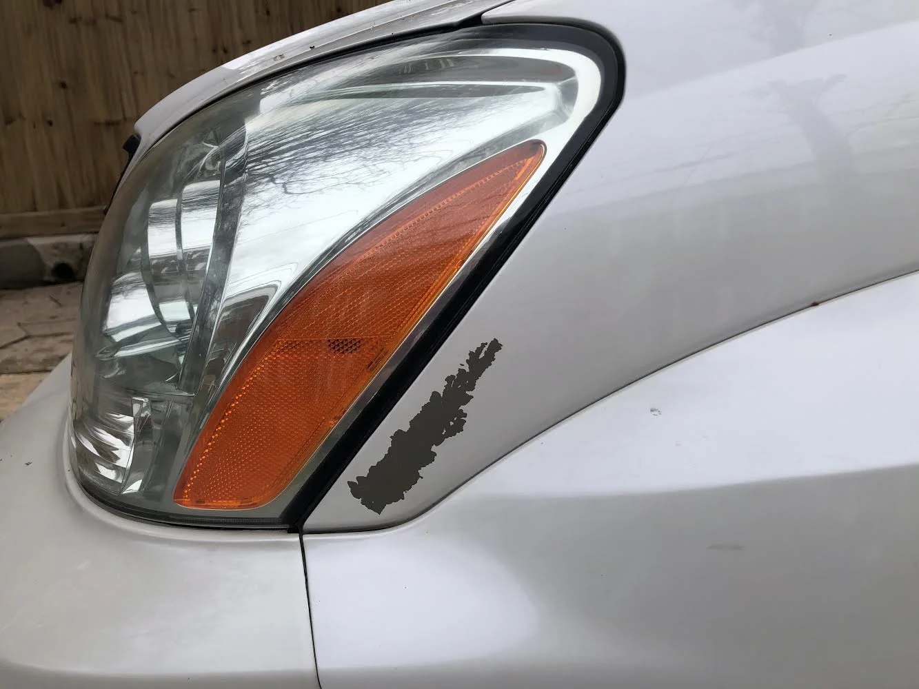

No update. The spot by the headlight hasn’t gotten worse, fortunately. Ended up focusing on other mods, and may reconsider my options when / if it gets worse.
DId you end up using the Scratch Paint product? Im still confused why more people arent willing to spend the extra mile (1-2 hours) instead of 20-30 minutes on these dime size or smaller areas and then applying clear coat beyond the actual repair area and doing a fine 2500grit wet sand to smooth things out and then a quick buff to get the wet sand out and it should significantly reduce the chances of peeling in that immediate area right? I feel like you see people who had one area of peeling, covered it with vinly or the sort and many of them end up with no peeling in another place for 1-2 years. If you were able to do this right when things started, depending on where your car is stored etc, it might be possible to get many years of no significant peeling if you are willing to do each touchup correctly so that the clear coat extends beyond the actual chip/peel area and then blended in with really fine wet sanding.
Did you end up doing any of these temporary things? (not necessarily my method, but temporarily fixing the peeling areas and it didnt get worse?)
Also, to anybody who is more experienced than me, if the issue is that the paint isn't adhering to the car itself, wouldnt this mean that it needs to be stripped down to the metal & plastic all the way? So when someone like OP says they want do to the prep work, how does one properly strip all his panels down to the metal?
pretty much have to strip it down, yes. that’s why, once it starts, it’s just a matter of time until that panel gets much worse. my guess is that’s why you don’t see folks do spot repairs that involve sanding and buffing an area around the peeling. at least, that’s why I won’t spot treat mine, and why various higher end paint shops wouldn’t either.
as far as stripping it down, everything I’ve seen is sanding. There’s a thread somewhere in here where a forum member bedlined their GX (rhino liner, I think). He detailed the prep process well. Lots of time taping, sanding, and priming.

So you ended up doing zero touchups? I get what youre saying but its odd that there is no documented place of someone trying. If you have an area the size of a pencil eraser or smaller which is typically how this is all starting based on the photos ive seen, why is there no documentation of someone even attempting to use a touch-up kit to cover it up and then put clear coat over it and see if it would at least slow it down. Maybe after 2-3 times of doing that and it not being very effective they would give up. I still find it odd that I legit have not seen once documented attempt at someone even trying a touch-up kit on peeling GX... just vinyl or much larger sand and repaints on areas much much larger already.
Correct, I have not touched it up at all. I can’t speak for others, but id rather have the large gash than have to repaint the fender.
Did you get advised not to touch it up? Confused where this fear of making it worse comes from. So far all the documentation shows that the only people with significant peeling never did anything about it. 2 cars I almost purchased had small amounts of exposed primer and they simply covered it with vinly and it didnt seem to get worse. Seems to me that the biggest risk in things getting worse is allowing it to be exposed and the moisture, water, grime to creep underneath and it just gets worse and worse and to the point of no return
It’s going to get worse whether you touch it up or not because the problem is the primer not adhering to the body.
every method of touch up is going to involve sanding the area around the peeled paint. If the primer doesn’t adhere to body, then sanding just leads to more chunks coming. Once it starts to chip, even wiping microfiber cloths around that around for a hand wash can chip it more.
yes, when I talked with some of the higher end paint shops around Atlanta, they all said they wouldn’t be comfortable doing touch ups because they were concerned that as soon as they start sanding, the paint would keep peeling.
Had a really nice detailing place refuse to do paint correction on other parts of my car after they saw the peeling up front. Same reason: they didn’t want to put the rotary buffer and have paint just peel off.
I know it’s going to get worse, not if, but when. I’d rather not speed the process up trying to do a touch up that won’t even look great once it’s done.
