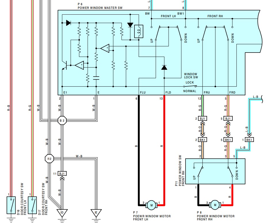

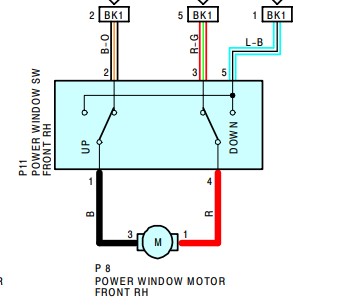

Have someone roll up the passenger window from the driver switch. Look at my zoomed in picture.
While he's holding the switch "UP" (with the passenger switch plugged in) test for power
Terminal #1 and terminal #2 should have power.
Terminal #3 and #4 should not
Terminal #5 is the power for that switch, it will have power but were not testing that.
Roll window down from driver side.
Terminal #3 and #4 now have power
Terminal #1 and #2 should not
Report back with what you find.

Reporting back. No power when doing these checks. I checked continuity between the wires and the master switch and it came back good, so I realized the issue must be the switch itself, swapped it with a rear one and now it works from the master switch! Thanks for the help in the troubleshooting!
Glad you got it.
When diagnosing something like this, I normally start where ever it was worked on. Its not uncommon for people (in this case the glass guy) to pull apart switch's then reassemble them wrong or missing parts. Many decades in the industry taught me to start with whatever was touched last. Don't get me started on alarm and stereo people.
If I was to throw a part at it, it would have been the passenger switch. Also, the passenger switch gets its ground from the driver switch. Because the passenger switch worked, that proved the wiring between driver and passenger. A quick pin test at the passenger switch, tells about everything.
