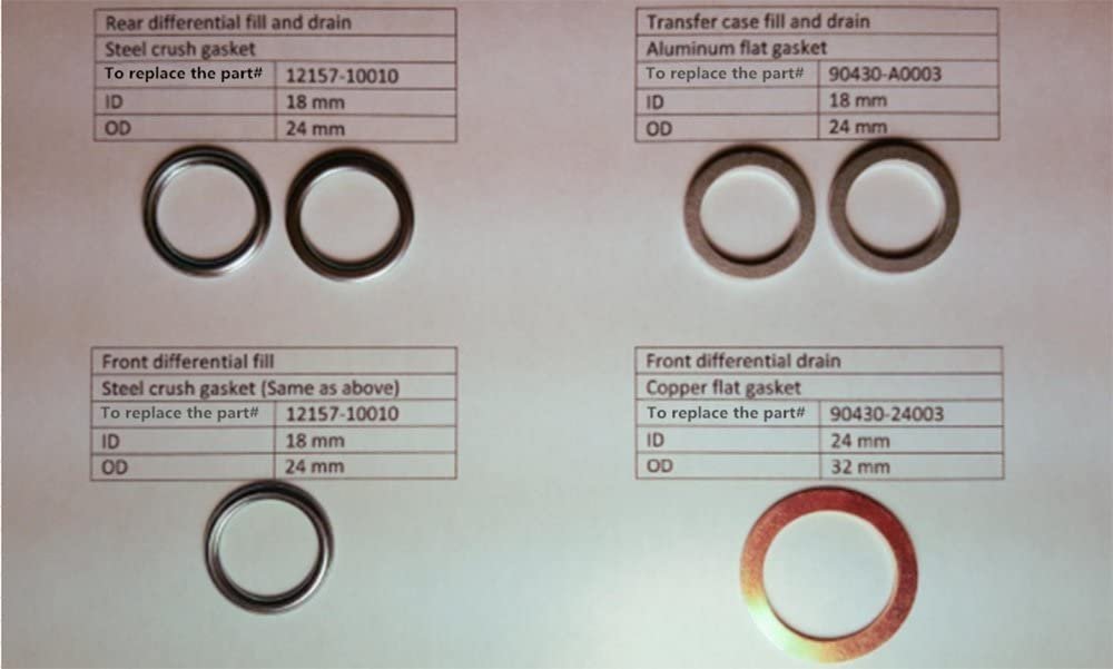

I dont recognize that p/n. Partsouq doesnt even pull it up for my 07 LX.
The drain and fill plugs for the front and rear diffs use the same steel crush gaskets. The transfer case uses the same aluminum crush gaskets for drain and fill.
Thats what I though as well, but I see some people saying that Front Differential Drain Plug Gasket is that copper one (I see it listed for 2008+ LC, 2001+ Tundra's, but not associated to 100 series).
DBull, where did you get the info that was the correct one? (or is that pic for a tundra?)
