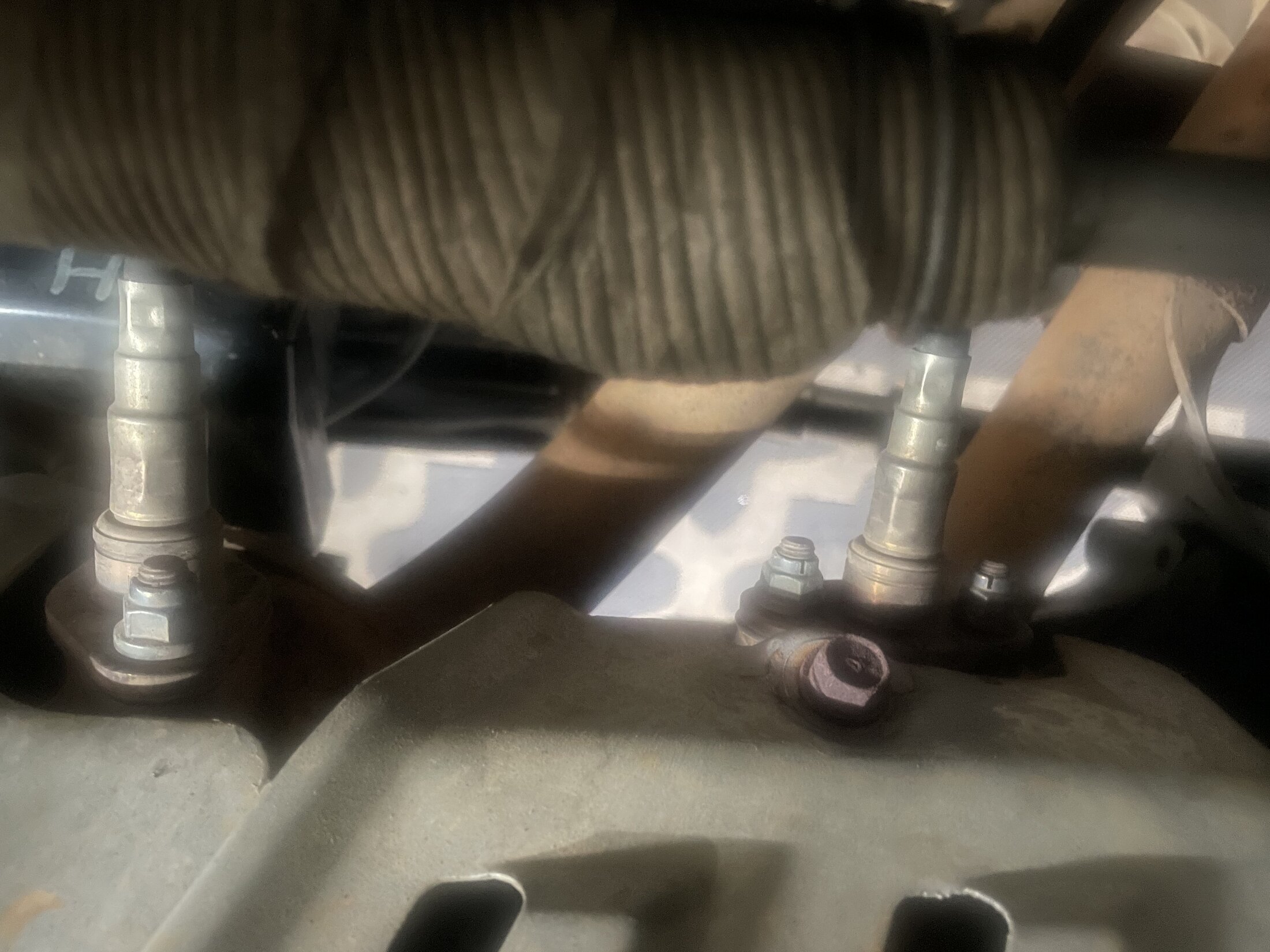

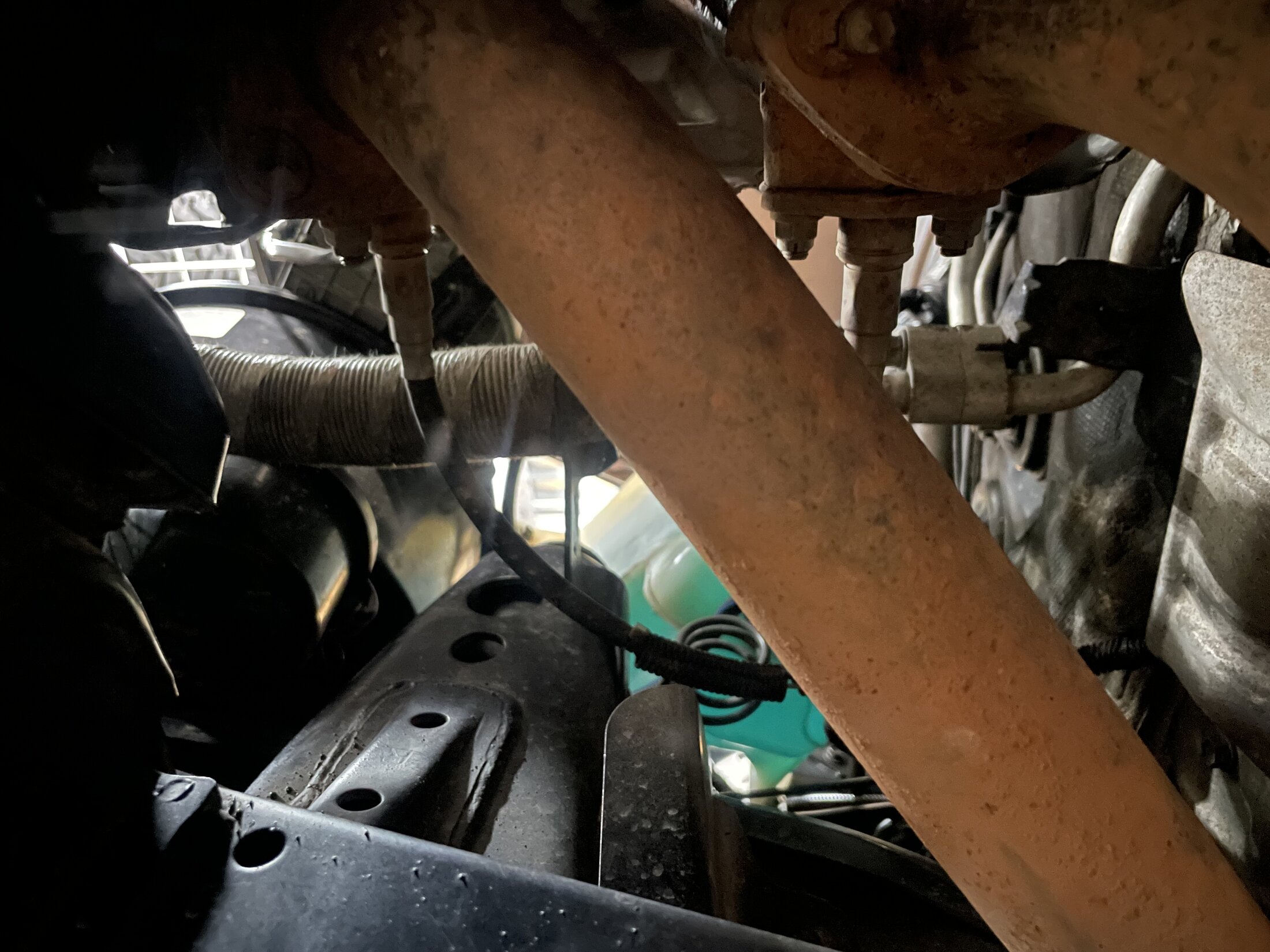

The one that the wire comes out of the passenger side firewall goes to the front bank the one that runs down by the transmission goes to the rear bank. These pictures suck but hopefully it helps.
