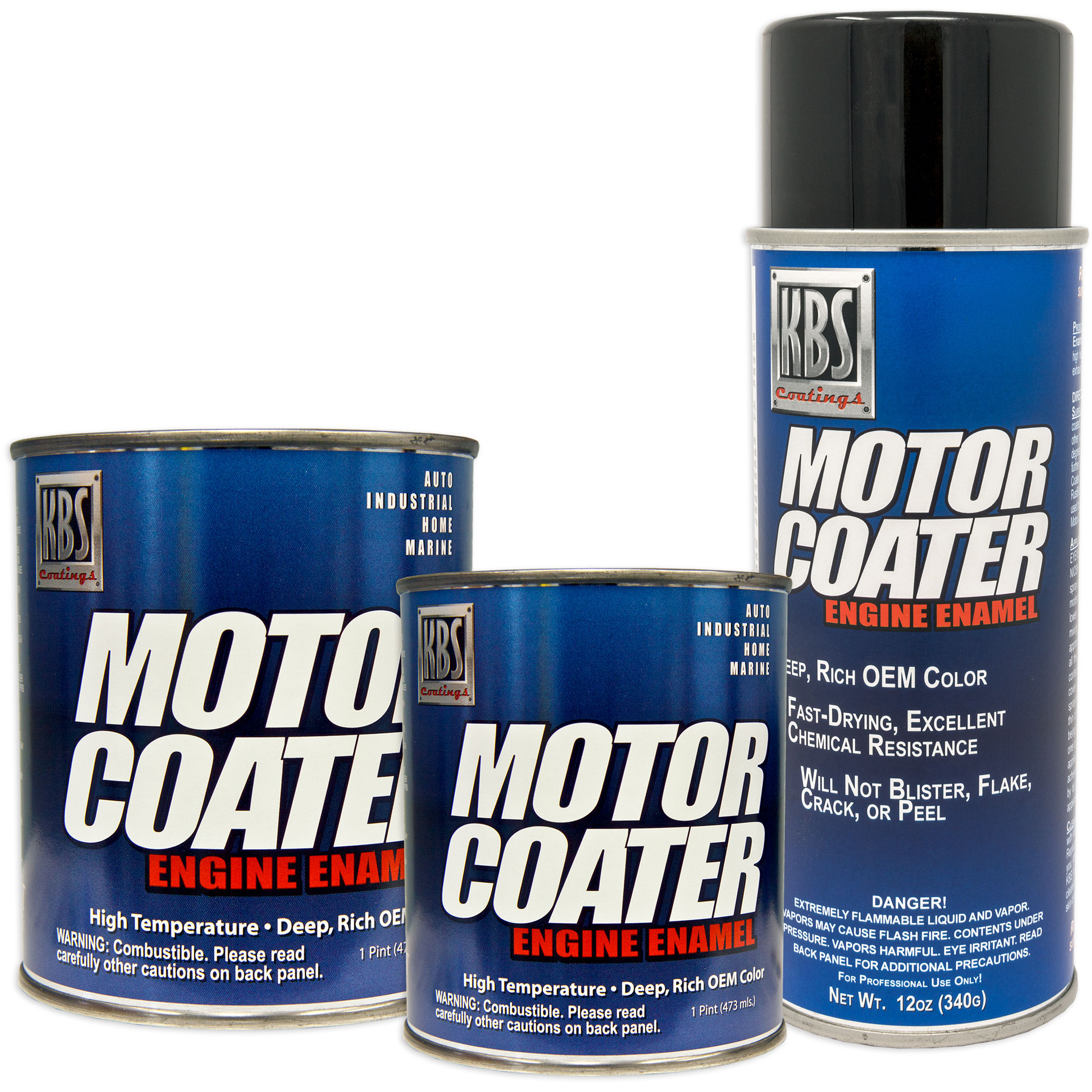

Paint is prolly paint. It will just get covered in grime anyway so as long as its protected and doesn't burn off its prolly good to go. I don't have a particular brand I could recommend however. I have had good success with VHT but never used it on an engine. Mostly frame/axle parts. Whatever you go with keep it flat so when your engine leaks oil or something else you will be able to see the shine against the flat finish of the motor. HTH.
Mask off the mating surfaces. Paint on gasket mating surfaces can break down/wear and cause leaks.
Any of the high-temp engine paints you mentioned will work fine.
