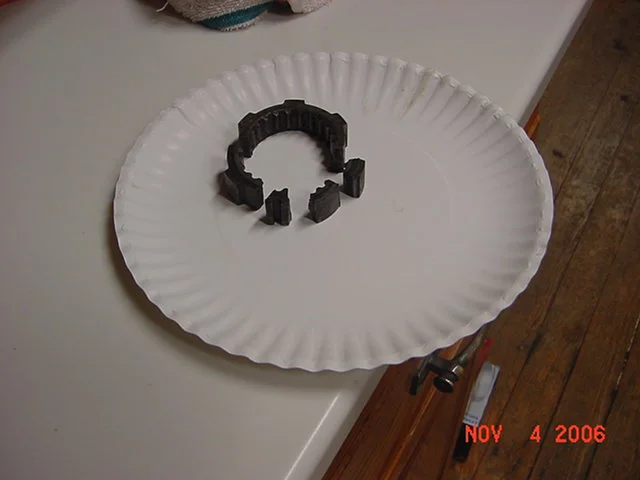

started the axel rebuild tonight...to the selectable hub off and this fell out....what is it....and where can i get a new one since this one obviously needs to be replaced....so did you have trouble locking in your front hubs??????...let me know and thanks for your help..

thanks my addy is on the way...i have not opened up the other side so i do not know what is in there...i have a quick question....inside the hub there were two large nuts....they were not tight....i fished them off of the spindle?...with my fingers...should these be tight when i reassemble?....also...how much grease is too much?...thanks for your quick response...aside from the mess so far this is not a bad project....:eek:
marc
They need to be tight, I have the torque specs somewhere. I didn't tighten much up when I reassembled it, knowing you'd just have to take it apart again. Do you have a hub socket or do ya need to borrow one?
