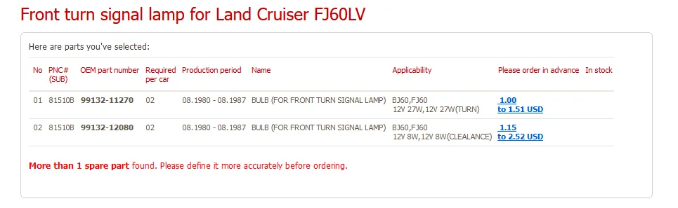

PA turn signal bulb question
The turn signal lamp is toyota 99132-11270. This is a 12V 27W bulb with a single filament bayonet connection bulb. This cross references to Philips 1156.
The running light (Clearance light) is toyota 99132-12080 which is 12V 8W single filament bulb with a single filament bayonet connection. I think this is a philips 67 bulb
Thank you!!!!!
if using LED's you CAN install a 1156 into the lower clear corner lamp location on a FJ60
NO heat = a good fit
using a incandescent filament bulb will MELT the lens in moments
