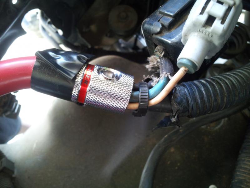

Question: I fed all the factory power cables into a splice that goes into the cab of the truck in order to relocate the batteries inside. Could the poor connection of one of those leads be the problem?
No dice so far. COULD THIS BE AN ISSUE? look at the pics and how my power cable are all into a single splice for the relocation. Feedback? Thanks in advance
You might try bolting your igniter back on to the body and make sure it has a proper ground.
If that does not work: Yes, those connections could be a problem if you are not getting the proper voltage to your igniter.
Honestly your best bet is to get a multi-meter and follow the FSM in CreeperSleepers first link.
Habits, you are the MAN! bolted the igniter to the fender and grounded it properly and she turned right over! Thank you:beer:
