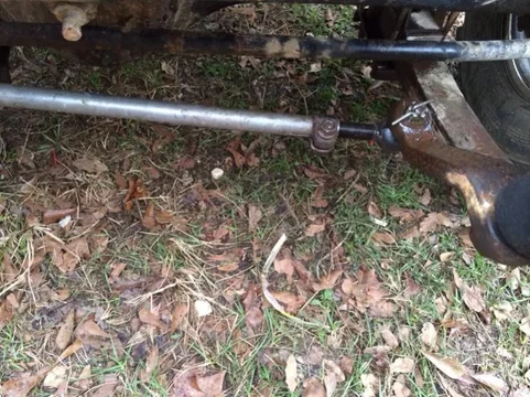

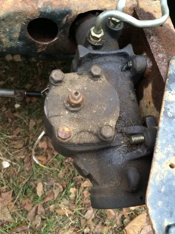

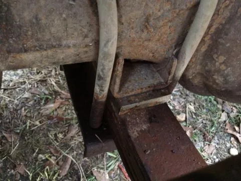

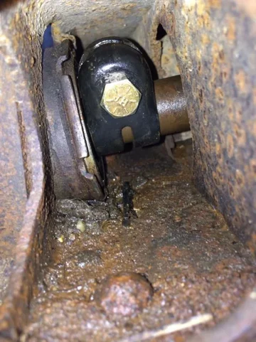

Update I got it driving good and stable now. The drag link. Pitman arm, tre, and caster shims from btb. The caster shims are only need if you have a lift and the degree of them very and depends on how much lift you have. Mine are 4 degree and work good but I still need a stabilizer image-1734381251.webp image-3194055126.webp image-4231072135.webp image-3788136434.webp Caster shims Sent from my iPhone using IH8MUD
I changed my column choice to a 90 s10. But it's just like van column anyway, I flipped the gm bracket backward and took about 3/4 of an inch out of hight to tuck it closer to the dash
