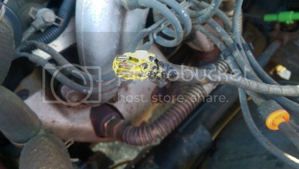

One of my o2 sensor connector (yellow connector in red box) managed to fall against the engine and melt. Can I just purchase the connector or will I need the entire wiring harness? Or am I up for a trip to the junk yard?
So it would appear that you got your connectors figured out, only to have one melt on you. For a new connector a junk yard would be your best bet. Or, you could cut the connectors out and hardwire them. Did you get the new exhaust system installed? Rising Sun meeting tomorrow night!
Yep. Driving home from work on I-25 when it happened. Blew my EFI fuse. That was good times. :censor:
Here's what it looks like now.

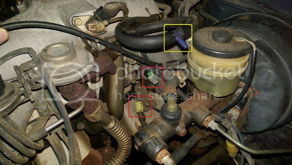

Can someone please tell me which O2 sensor connects to which exhaust pipe? I think the connector coming off the side of the engine (pictured above) would go to the front pipe (1,2,3) and the one over the transmission would go to the rear pipe (4,5,6), but I want to be certain before I splice the melted connector in.
Thanks.
Also, can someone please tell me exactly where the other connector should be? I've read that it's somewhere on top of the transmission but I can't locate it to save my life.
I was able to locate the sensor above the transmission (I actually had to take it back to the muffler shop and have them show me... :( ) and get the front sensor spliced in. After which it passed Denver emissions with flying colors. And no more CEL!!!
