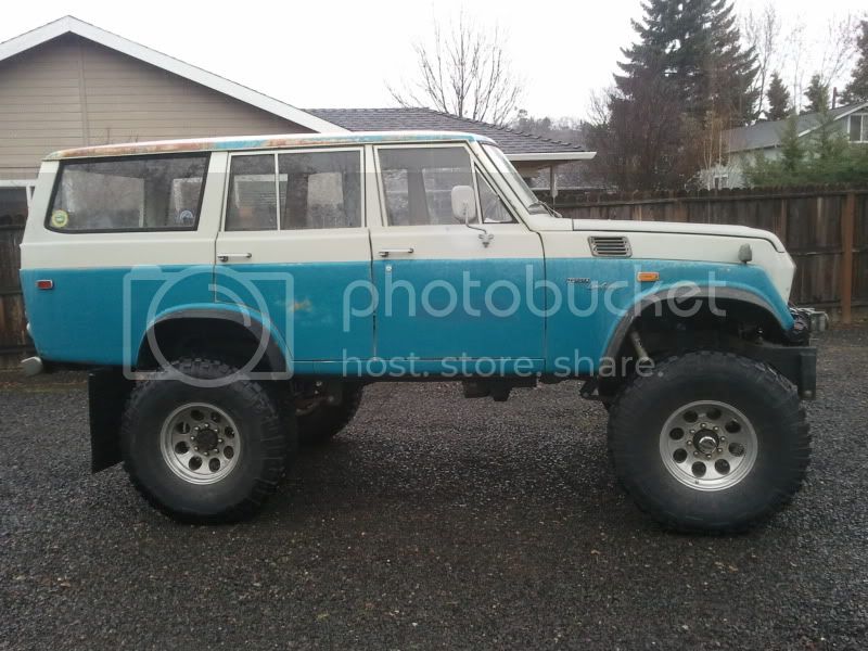

I use these repo's that are for a FJ40. Problem is they tend to move whenever the door gets closed and there is no way to tighten the hinge on them. More for the police than me. I think they were like $20 new.
Never crossed my mind to use those but they look good on yours! May be just the ticket and are readily available too, thanks.
Mako
if you pull them off, can you get to the spring inside the base and tighten the nut up against them?
You can get to the spring but there is no nut. I want to say there was a roll pin holding the spring in. I was thinking of disassembling them and threading the rod and putting a nut on it to make it tighten-able.
