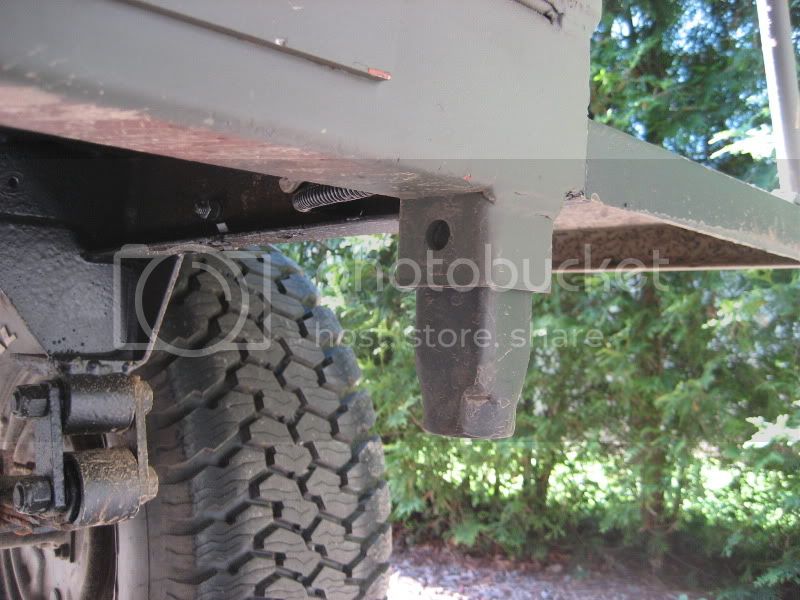

sounds like a good idea should work fine.. i went with a much simpler approach, cuz i like simple.. but im gonna build another trailer with all the goodies just because its so much fun..
here was my solution to the legs..
Actually it was your design that starting me thinking about the idea and once I saw the same basic design on the traffic signs I decided it's what I wanted to do. That's what I really like about this site....sharing (or stealing :D) ideas with one another! Thanks guys.:cheers:
