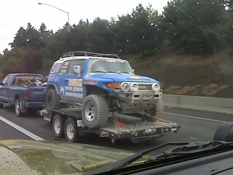

I saw you guys the other day driving up I-5 just before the bridge from Portland to Vancouver WA. I was driving my green 4 door Rubicon (lifted with a bunch of goodies) and I waved at y'all.
