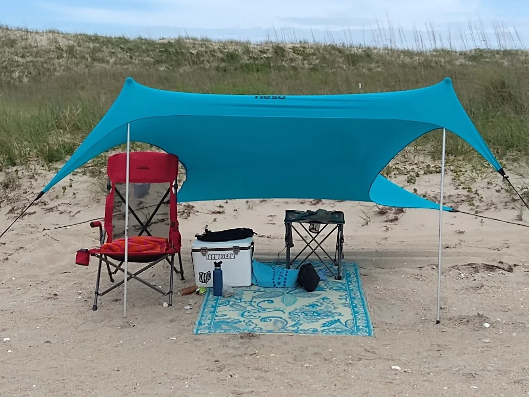

We ended up buying the Neso 1 sun shade for a trip to the Outer Banks of NC. We used it every day we were there, both soundside and oceanside (Ramps 55 and 72). By following the instructions + additional guidance, this shade easily stood up to the constant winds on the OBX (15-25mph for 4-6 hours/day, with higher gusts).
  1. Stretch it out so the shade will be taut before raising it.
  2. Dig holes in sand for the bags - in the soft sand, this took a few minutes by hand, and I used a small shovel for wet sand.
  3. Place bags in those holes, completely fill them with sand, cover the bags with sand.
  4. Grab the poles and push up the front - poles should be a few inches from the leading edge.
I was absolutely blown away by how effective this was, how quick and easy setup/tear-down were, and the small size == not too large of a footprint + enough shade for my wife and I. We only had to adjust it once in 5 days of use. Now I need a CGear sand mat (and a shorter chair for my wife) for the perfect beach setup...

I would very much encourage you to at least try using the sandbags that are included - I was impressed how well they work.
I dug holes about a foot deep, dropped the bags in, filled with sand - this is the most important step! - until I couldn't stuff any more in them. Then covered/buried them.
I've never really had much luck using stakes, although I did cut some 1" PVC about 2 ft long and pounded them in the sand to use with a Kelty Car Tarp. I drilled holes about 1" from the top to run the guy lines through, and it worked fine on mild days, but not on the really windy/gusty days.
