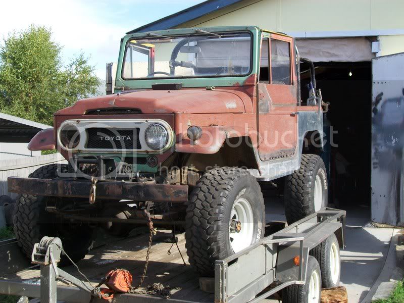

I'm not sure this helps to answer your question, but on mine, it does not appear to thave any of the gray primer under the dash and interior. There is a very light coat of the reddish brown sealer and then the topcoat (freeborn red). I've only seen the gray primer (perhaps a surfacer) on the exterior panels.
The only other Land Cruiser I have that I can tell you for sure about original paint is a 79 fj40 and that used a green/grey sealer then a white (031) topcoat.
I took most of the paint off my 1968 40 with a scraper. Under the green paint was a red sealer over the steel and then what looked like a red primer filler over that.
But then a 78 model i was doing some work on had a greenie colored sealer then grey primer under the dune beigh.
