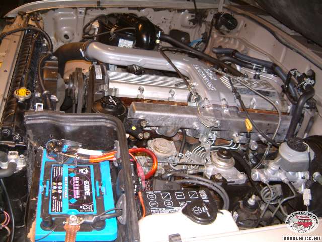

I had the same problem
I just losened the cabelclamps pulled it as long as i could and fastened it again.(or maby i diden't fasten it again, i dont remember anymore ) :P
Is that the cable clamp thats held down by a screw?
the exide maxxima got a 10mm senter pole with a stamdard nutt(not sure how to spell that but the thing you put on the screw) as vell as standard batteriterminals. great if you Want two or more batteries,ihave two ground wires one directly to chassis and one to the engine.(closest nutt)

Neowulf you only seam to have one battery and tray. In UK two batteries are standard for the Di :confused: esels have you removed one or is that standard?
its standard on the HDJ80 models i got a HZJ80 :)
