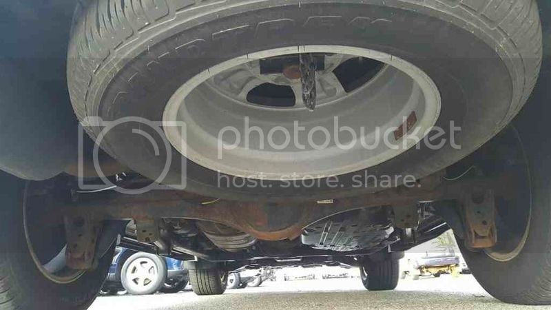

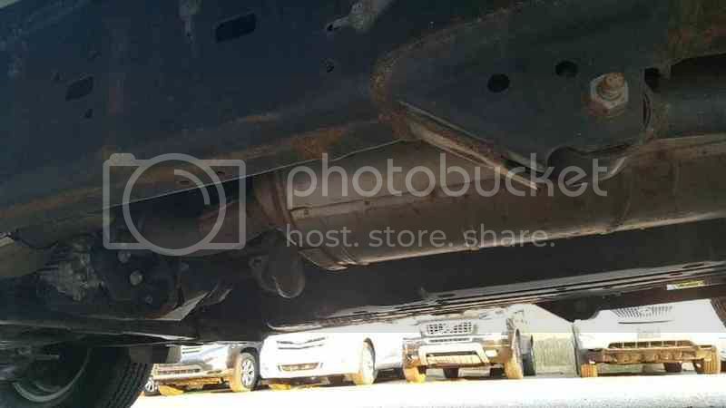

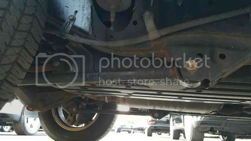

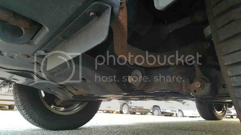

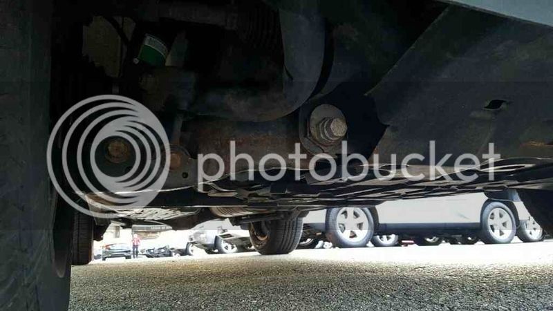

Looking at getting the Wife a 200, been browsing for one off and on for a while. Came across a decent deal in NY, being from the west coast and not having to deal with salted roads, what would your opinions be? The interior and exterior are in excellent condition but there is some rust on the undercarriage. The truck only has 50k miles on it and it is a 2008. The truck spent its first 3.5 years in Texas and the last 3.5 in NY.

Of course a southern truck would be better but that's all frame surface rust. Wire brush and a few rattle cans and you'll be ok.
Everyone that lives in the north should be doing that to increase the longevity of their Yotas.
Have a 2007 4 runner that spent life in ny and pa. Always washed it every week in the snow and just wire wheeled the underside the.n used rustoleam sold at harbor freight and chassis saver. Took all of a few hours and a couple ramps but looks better than new. Very cheap to do as well.
That all looks like surface rust so wouldn't scare me if the deal is right

Agreed, my concern would be frozen bolts and rust pockets underneath not shown in the pics.
my plan would be have it steam pressure washed if i was to buy it, wire brush the rust, then rustoleum it.
Has anyone owned a 200 in similar salted conditions? how have they held up? the price is just right for the mile $36k with only 50k miles.. super clean everywhere else. just a tad worried as i said before as far as frozen bolts or being able to repair.paint the hidden surface rust underneath? Any known spots i should be worried about and ask pics for?
