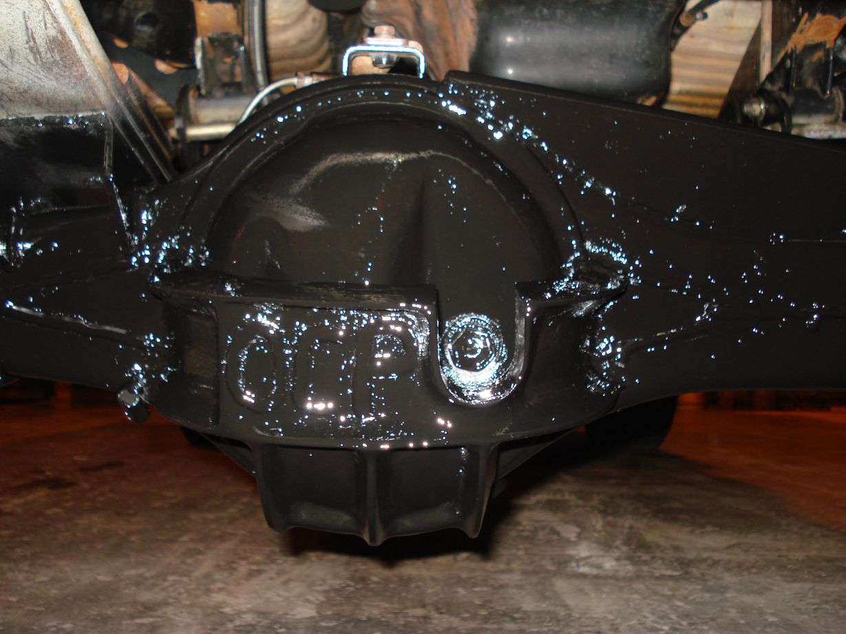

New updates as of tonight.
Diff guard and steering dampener.
It drives 100% better now!

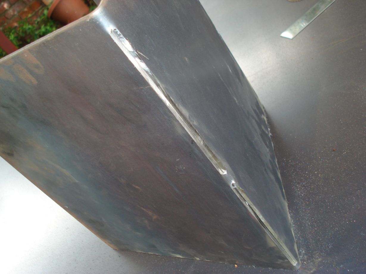

Quick bit of tech for those who want to bend sheet steel like this, bending 2-3mm sheet is tough if the bend is over 100mm long. What you do is you mark out for bend lines, cut all but a few 10mm sections like i have (i only used 3 sections, but for a longer bend you can use the same method but just leave more sections)
When bent the sections give a perfect radius and weld prep. Just do a vertical down weld along the seam like this
And the final product after a bit of a quick grind.
