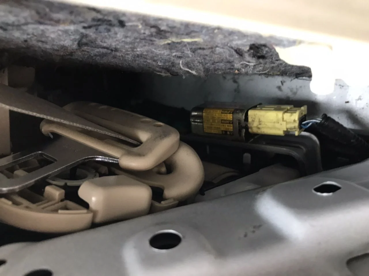

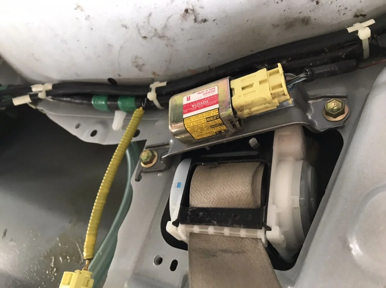

In an effort to thoroughly clean the aftermath of sunroof leaks I removed everything from the B Pillar. The entire belt area looked nasty so I decided to remove all the bolts and then took it in to soak the belt for a good bath/cleaning except....
in my haste to beat daylight I let all the belt slack retract into the tensioner until the "spool" wouldn't accept any more slack. Now the tensioner won't let me pull any belt out of it. I tried coaxing some if out by playing with the spool and pull on it. I tried it fast and also tried it slow. Neither will let me pull any slack.
I searched the forums and nothing turns up. I am tempted to take it apart but decided to hit the forums here.
I am wondering if I reconnect the yellow sensor wire to it that it will help. Right now, there is no power to it since I am waiting for Costco to come through on a new Interstate 27F battery.
Any help would be appreciated. Thanks.
@onemudder Try holding the belt housing perfectly vertical before pulling on the belt, as it is installed in the car. There may be a pendulum that is locking the belt. In a sudden stop it swings forward and locks the belt.
I wouldn’t apply power anywhere near the tensioners, and be sure to leave the battery disconnected when you reconnect them. It’s a small explosive charge if I’m not mistaken....

Thanks guys for the replies. @Ayune I followed your suggestion and IT WORKED! Keeping it vertical allowed me to retract and then extend it out normally. I believe there is a pendulum as you mentioned. Also, thanks for the warning! I'll be sure to leave the battery disconnected when I reconnect them. As I mentioned before there is no power connected now. Like @chrisratz I had no idea what the yellow wires denoted.
I'll post some pics soon, but it is interesting the warning labels, listed in several languages, but since the warning label stick wrapped around the tensioner the english warning was partially obscured. The Japanese part was fully readable, and the Arabic was 100% obscured only readable once you removed the tensioner from the pillar. Very interesting and maybe by design! Ayune, you were right -- The label says there is an "explosive initiator".

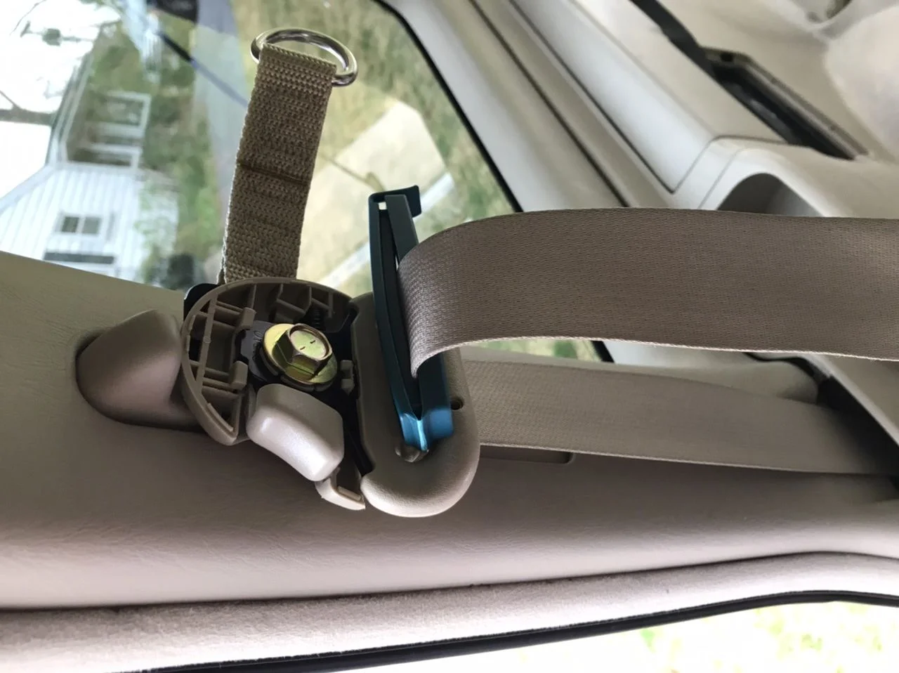

Just installed a Raingler cargo net (love it), and decided to try another mounting method for the 2nd mounting point down (near the 2nd row seat/C-pillar upper seat belt mount). I got the bolt out and then dropped the flipping seat belt mount, causing the belt to feed into the retractor rapidly.
Which locked the belt. It's as if the ALR is activated (see this post). I then undid the bottom seatbelt mount to give me more slack to play with, which the retractor promptly ate and refuses to spit out.
Truck is parked in driveway at a very slight incline--not enough to have caused any of my seatbelts to act funny previously.
Do I just need to pull the interior trim (again) and dismount the retractor and see if there's an angle at which I can hold it that will unlock it? Should I just turn the truck around in the driveway? Should I abandon hope and buy a new seatbelt retractor assy?

just pull the b-pillar cover to get access, it dosnt really take a lot to lock up the seatbelt. great when yuor in an accident, terrible when your working on the seatbelt and it constantly locks up on ya.
Thanks! Will do--I'll pull the bottom cover far enough out to let me feed a big more belt into the retractor (currently the sewn stop on the belt is right up against the opening in the quarter panel).

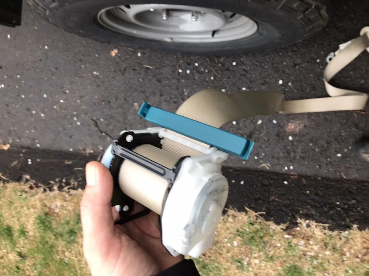

Well, pulled the front of the quarter trim out enough to feed even more belt into the reel. It’s now all the way in (wont even take more belt), but still won’t release.
Thinking next step is to pull the quarter trim completely out, pull the reel, and see if I can get it to release while dismounted...
Got it! Pulled the quarter trim, dismounted the reel, stood outside the car very gently fiddling with it, feeding more and more into the reel until the stinking thing finally decided to let me pull some out. I secured it with a chip clip to prevent a reoccurrence, and put everything back together—thanks for the input!
