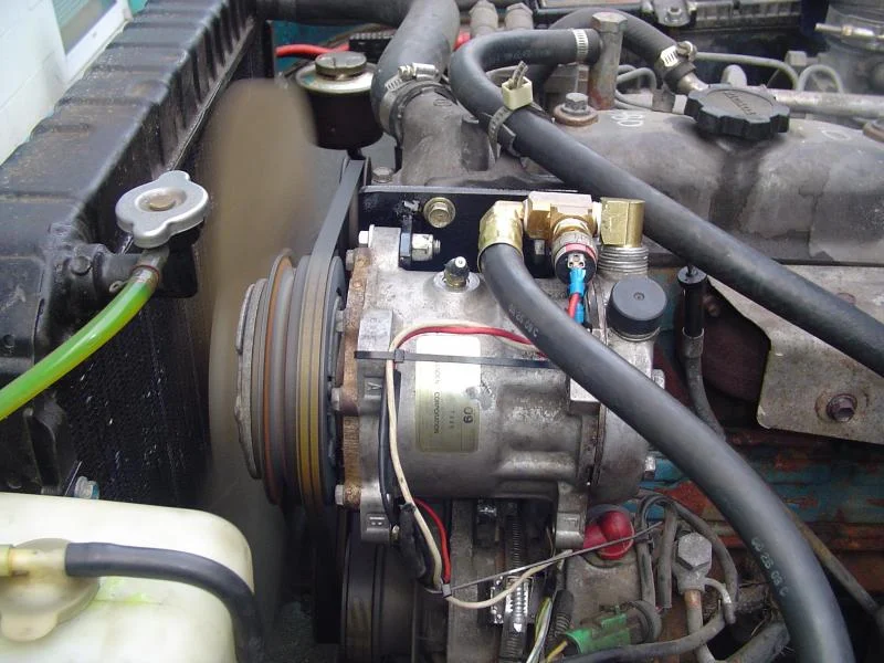

So I finally got my on board air installed and working, also tested it today and it worked great. We will see how long it lasts now. Hey Ken I have a york up for sale now.
Ya look great where did you get the compressor
if it's the 10 cu in. one I'll take it!:bounce:

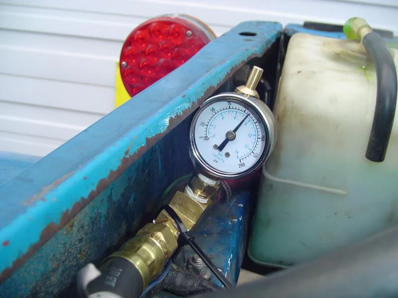

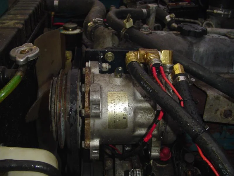

Here are some pics of the final setup, I also changed the pressure switch for a 100-150psi which worked better. The only thing I will change in future is the main air hose cause the old air hose with barb and clamp let go yesterday after airing Jay up. It got hot :popcorn:

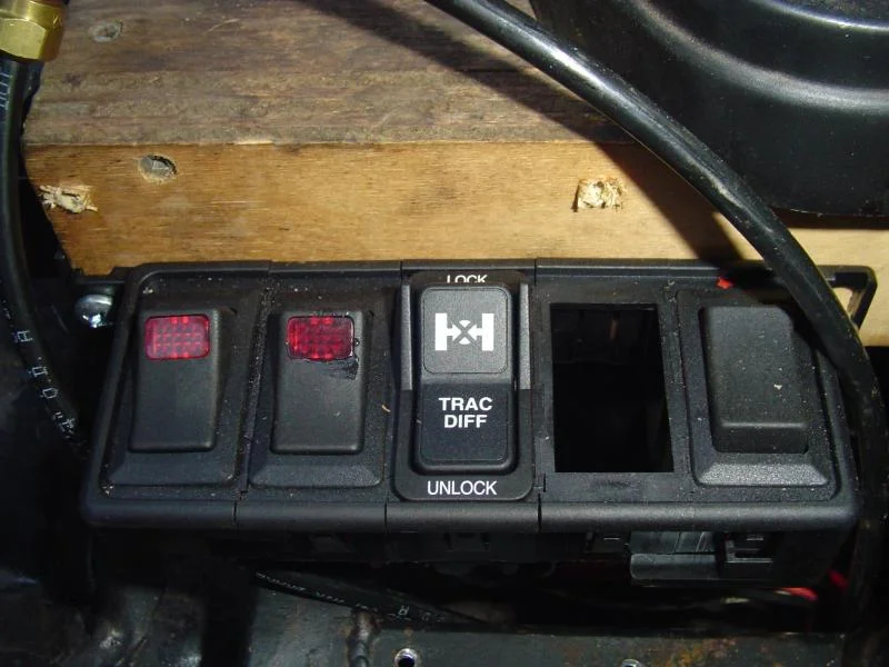

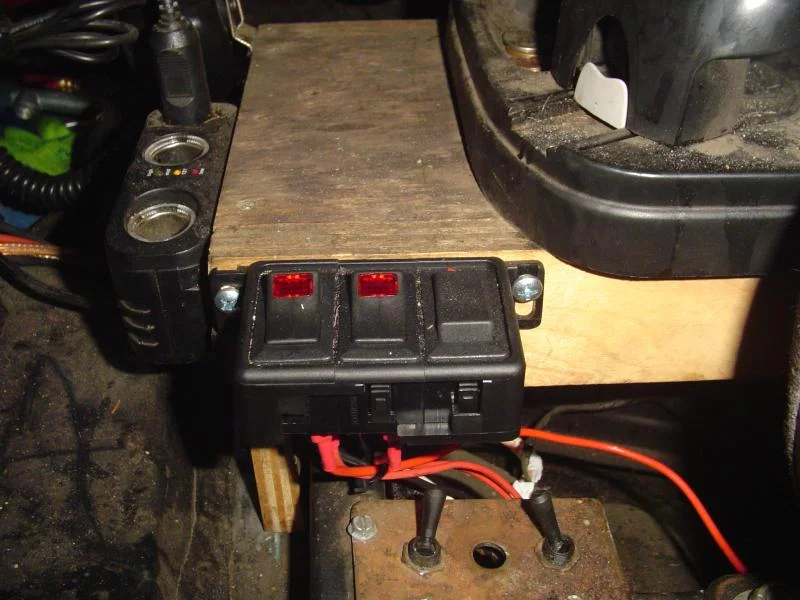

Last info on this project. So friday I upgraded the main line to half inch and all connections are bolted. Works way better. Also added a new locker switch I found at P&R. The first pic was my old one and the second is the new toggle.
