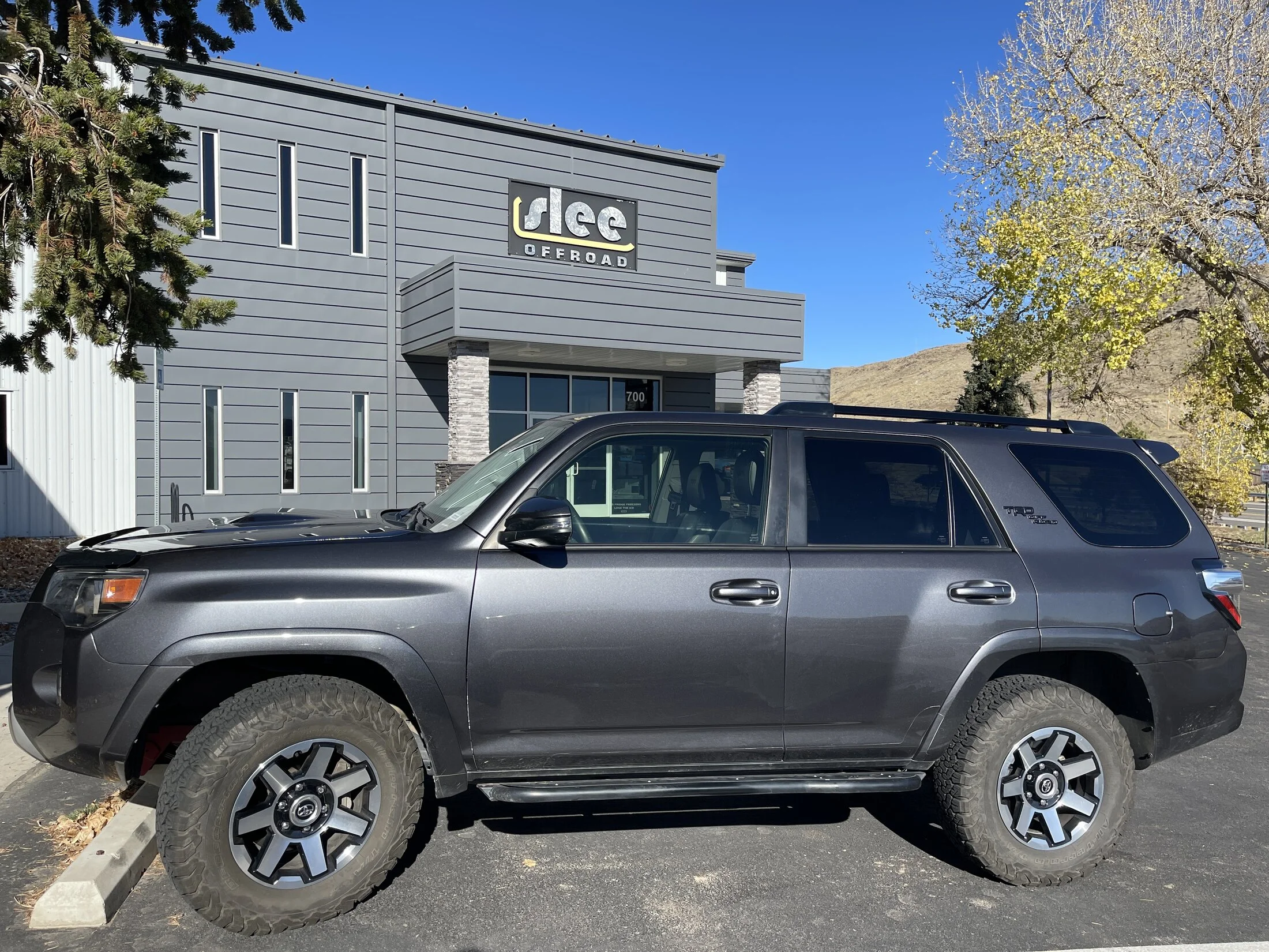

Dropped her off at the spa for a couple days!
Is this with the new OME suspension? How are you liking it? What'd you have before, stock?
That’s my truck with stock suspension. I should be getting a call from Slee to pick it up this afternoon and will share feedback/photos with the lift.

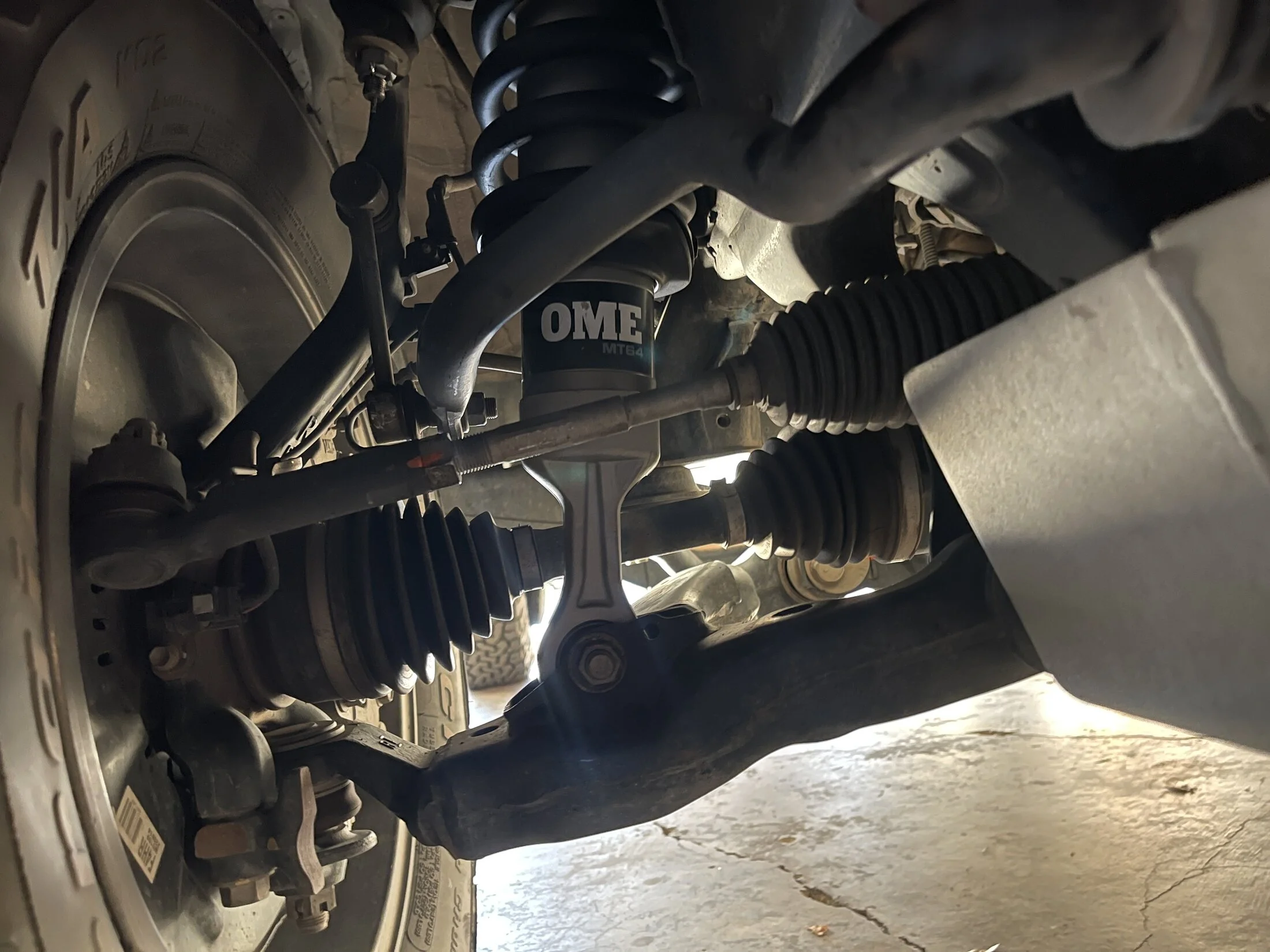

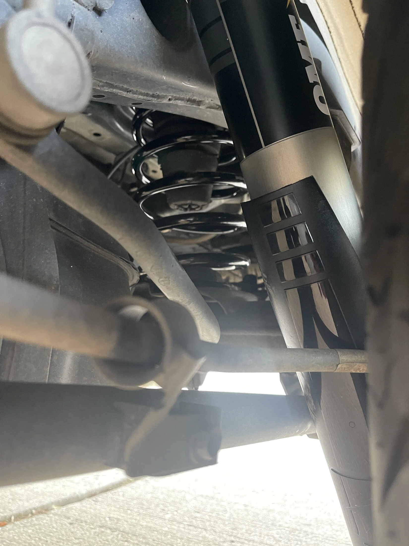

OME MT-64 set to 2” front and 1.75” rear.
SPC adjustable UCAs
Sway bar relocation
Front Springs OME (4007)
Rear Springs Bilstein (281817) - used for leveling in lieu of recommended OME spring.
Very happy with the work from @sleeoffroad and couldn’t recommend them more.

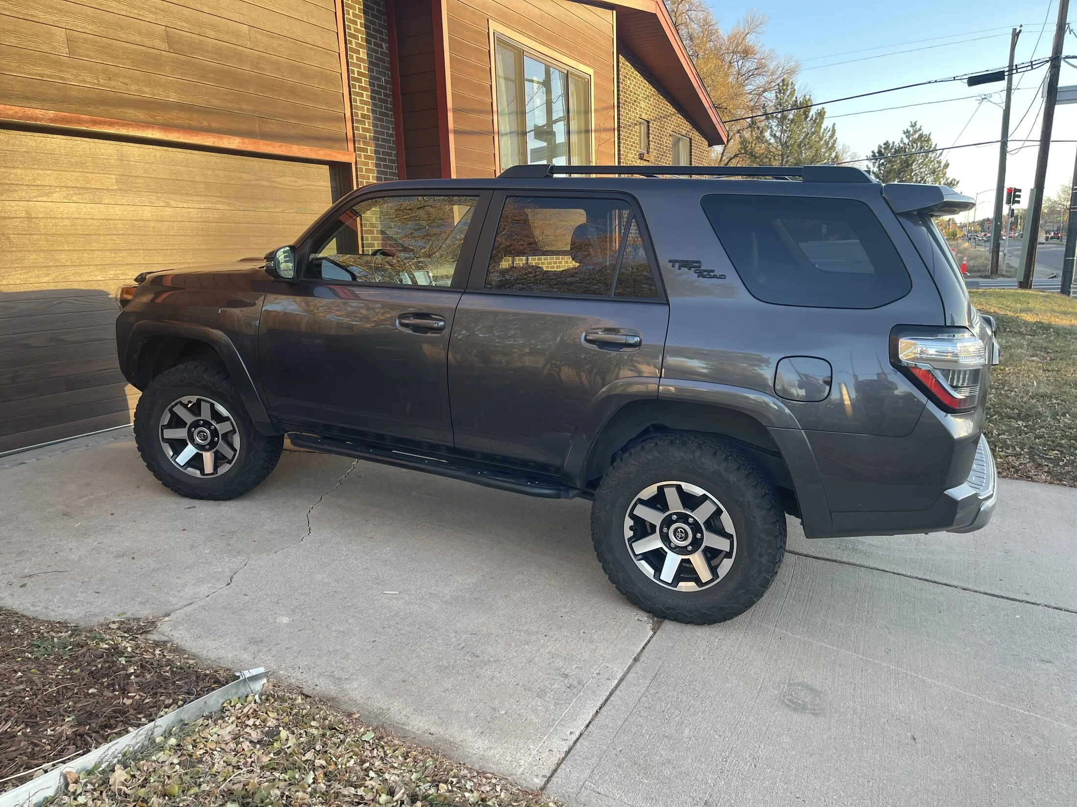

(Driveway is on an angle)
Looks great! I've always thought 4Runners need ~2" to sit right.
Thank you, I appreciate it! Agreed…it was a long time coming. My warranty is about to expire so I figured it was time to lift.
Initial thoughts;
Body roll is significantly reduced on turns/curves (non-kdss). Nosedive while braking has nearly been eliminated. Minor bumps and road transitions no longer send shock throughout the cabin/frame. I’m hoping to find a little dirt (maybe snow?) this weekend to see how it handles off road.
