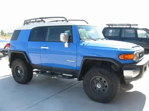

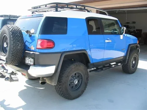

Here are a couple of pics of the FJ with an OME lift (885/895 and N140S/141). The ride is much improved...hitting rough RR tracks, etc. you can really tell the difference in the travel and how it soaks up the bumps.

Thanks! The wheels are American Racing. With 16 inch wheels the 285's will rub on the body mount on the DS. If you stay with 17 inch wheels they will clear. I trimmed back the body mount enough to not rub and then re-installed the mud flap. Works fine and you can't see the difference unless you get under the truck and know what you are looking at.

Do you have any rubbing with the 285s? I was hoping to go 295 with an OME, do you think that is possible?
What are the wheels you have on there? They look sharp!
I have the OME lift and run 295 Nitto Grapplers, Some rub of the rubber mud flap, but minor.
