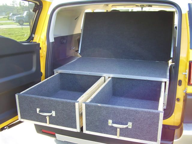

I happened to go with the 896's in the rear to accomadate the weight of a full-length interior rear cargo storage system. But, the 895's should do you just fine in the back.

Cargo box back aft works great with the mediums, even with the extra weight of the box and fridge setup.
Rides rougher than stock as noted here already, it should since the suspension is stiffened up.
Rides better in corners, handles better overall than the stock setup.
i was planning on building a box similar to that. good lookg box btw. do you have it loaded yet? do you find the drawers could afford to be shallower by another inch or 2? i'm thinking about putting a slide out "tabletop" in addition to the fold over type setup you've got there
