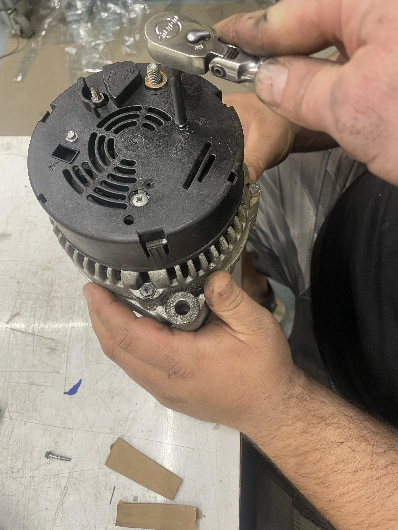

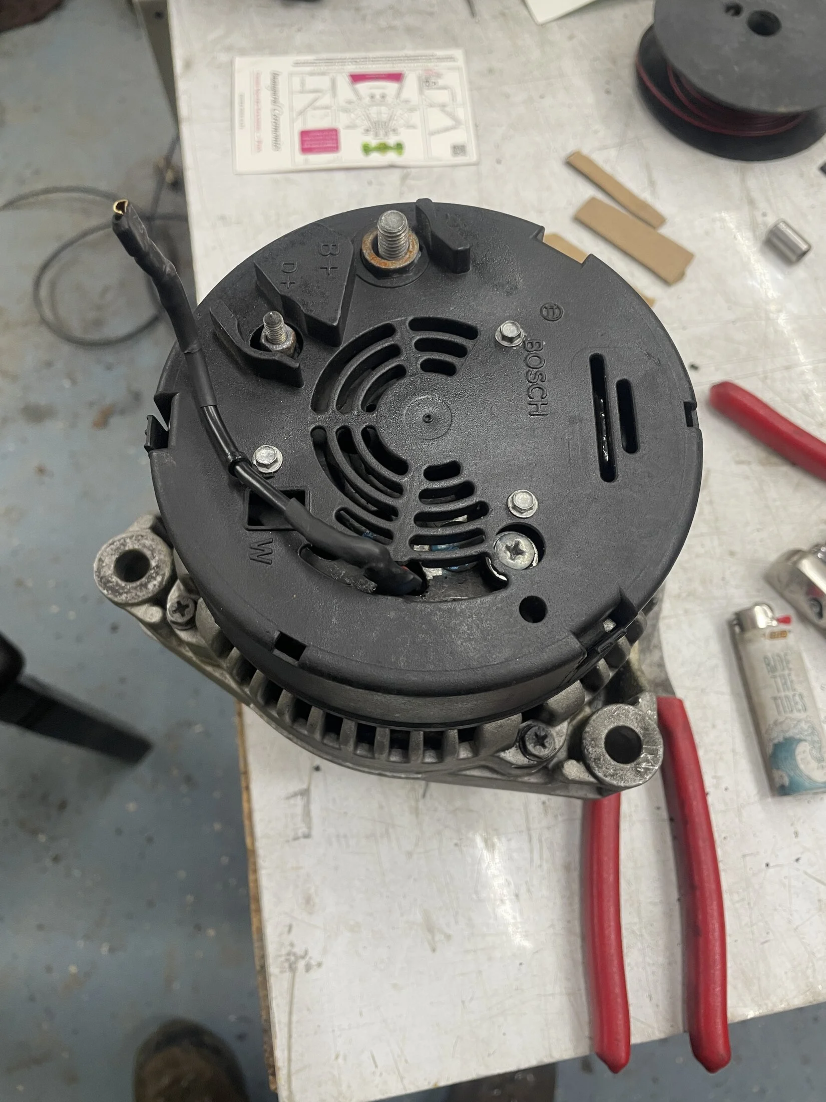

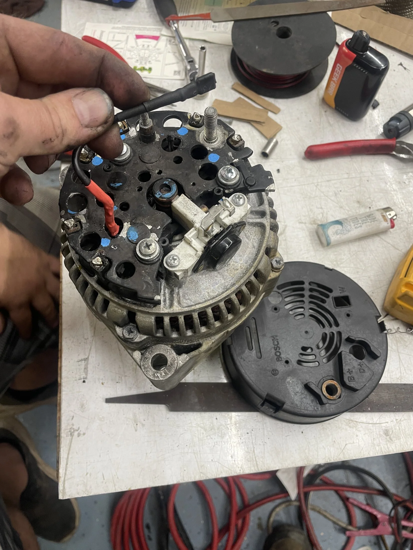

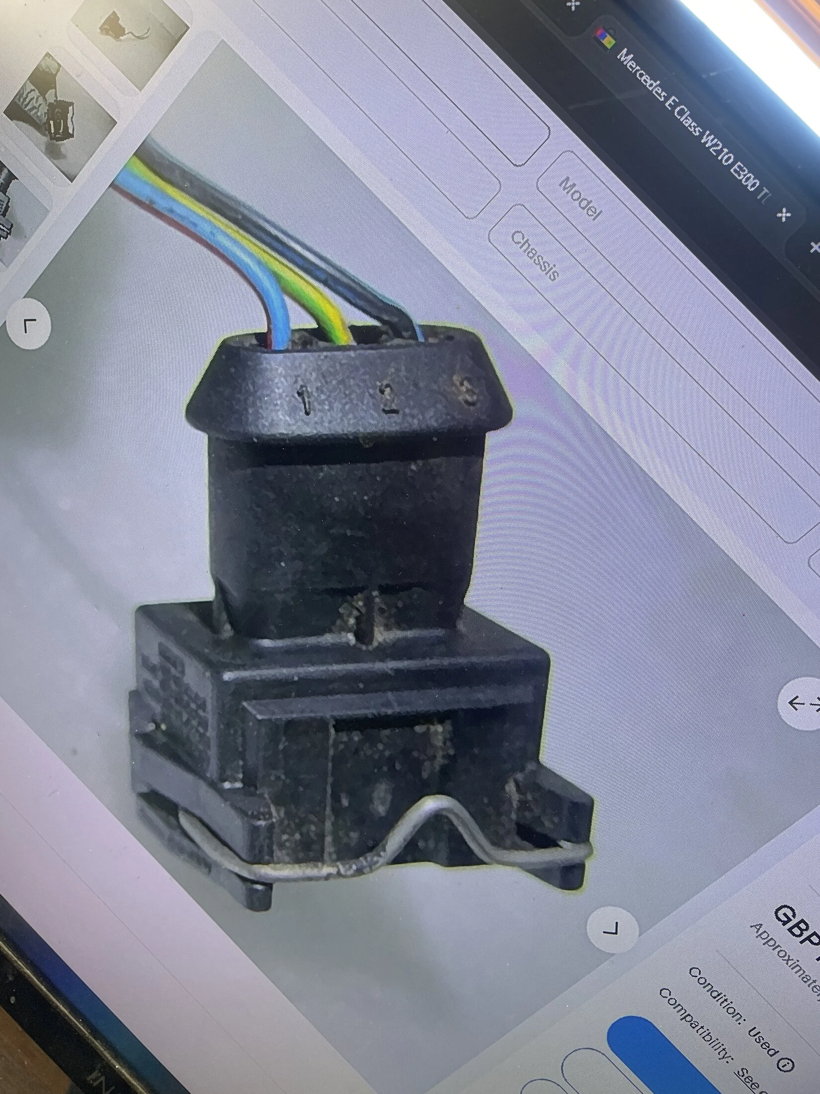

Here is an update on alternator wiring, and i found that pinout, for reference
I bench tested the alternator with the exciter powered, found out minimum 3volts a/c. then tied in for the Dakota Digital. their new unit also integrates speedo input, so i also get to correct for my 315’s. Win win.
Just filed this down for a good contact, then solder
And trimmed the back of the case
Now we have tach input to the dakota

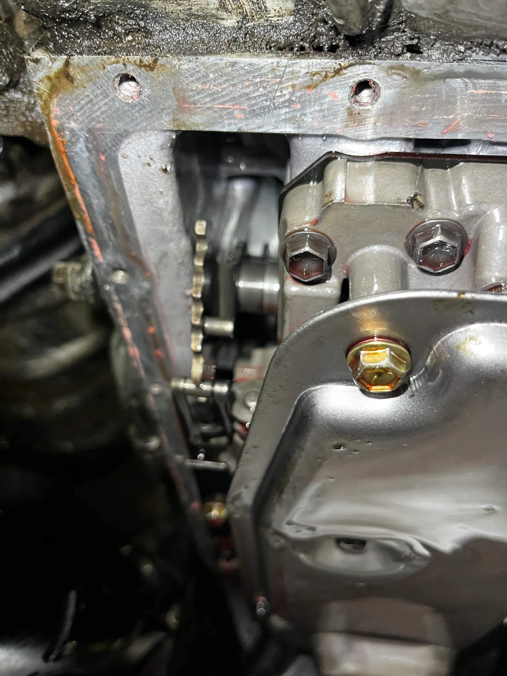

But I hit a snag...Transmission.
I upgraded to a transgo kit and a valvebody rebuild. My shifter will not phisically shift into L. Only park and forward gears work. Manually shifting the selector underneath the truck seems to be missing the the distinct 7th click for L. Reverse is also a forward gear. I also noticed that in Park, the engine is underload as I throttle, and will not rev freely.
I feel like I spent a massive ammount of time making sure I did't screw anything up, and was very organized, all was labeled. Trans and factory computer are plugged in. does anyone have any advise before I tear the valve body back out? Trans worked great before and now I have regrets not waiting until after the swap to dig into it. Thanks
