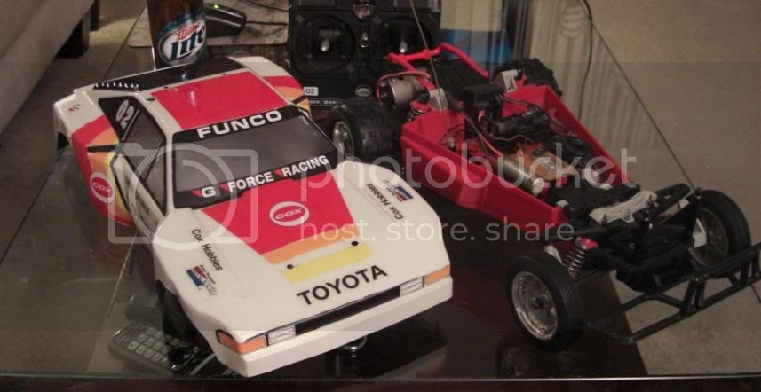

Thanks to Dirtgypsy's tamiyaclub recommendation and digging through their forums I found some links to vintage RC sites and found the make/model for this thing. It is an early 80s Kyosho Cox Ultra Stock Toyota Supra Stadium Racer (chassis ran under various names - Kyosho Pegasus or Cox Bandido-1985). I really misjudged the age of it and how long I've had it... This RC is the first I had purchased that required assembly which is the part of the reason I am pursuing getting it running again.
After checking the electronics it appears all still work with the exception of the speed control... Oddly enough the chassis, complete with all electronics (including the speed control), is on ebay for $10.00. :clap:

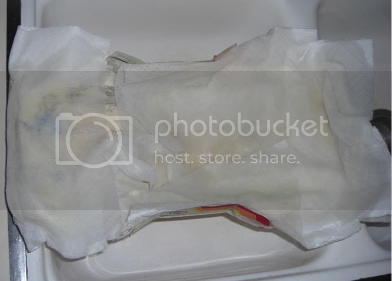

I taped off the holes in the body, lined the entire body with paper towels saturated in Dot3 and let it soak overnight.

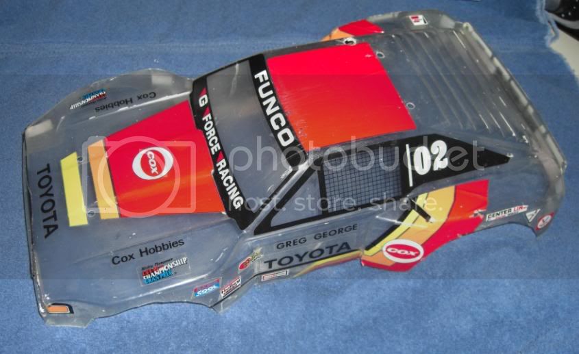

Some warm water and a sponge the next morning and the existing paint slid off...

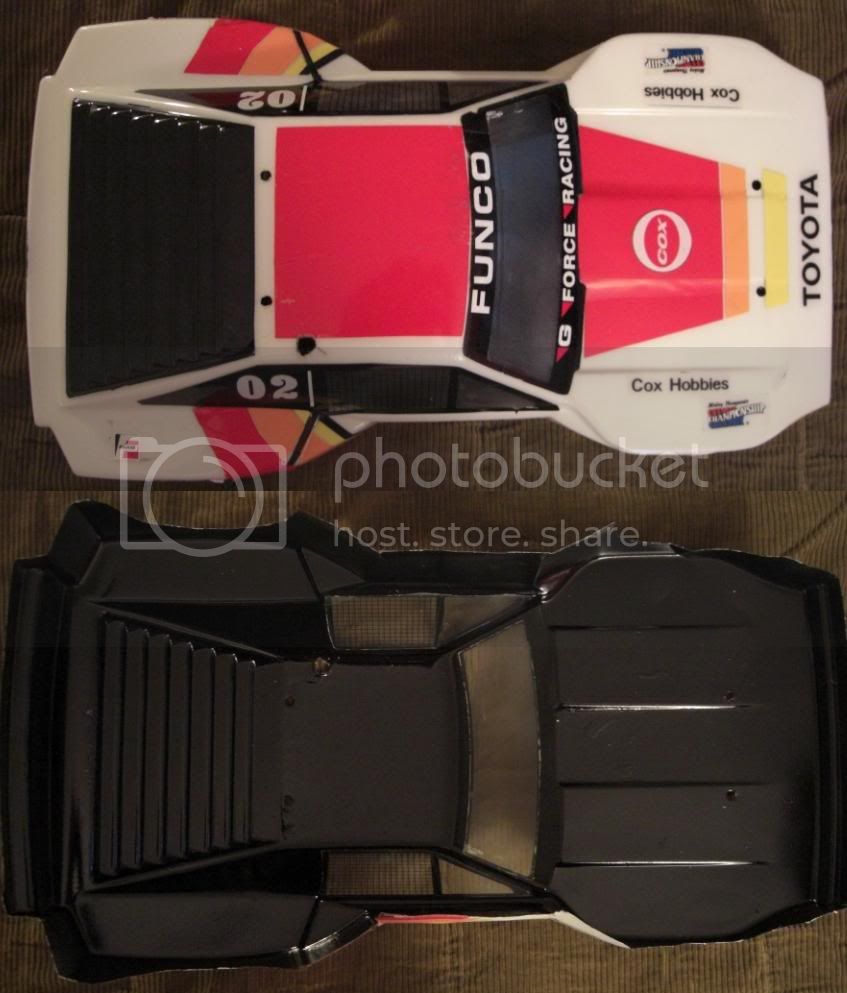

I had a can of Pactra fluorescent white and black undercoat on hand.... 5 coats of white with 2 layers of black.

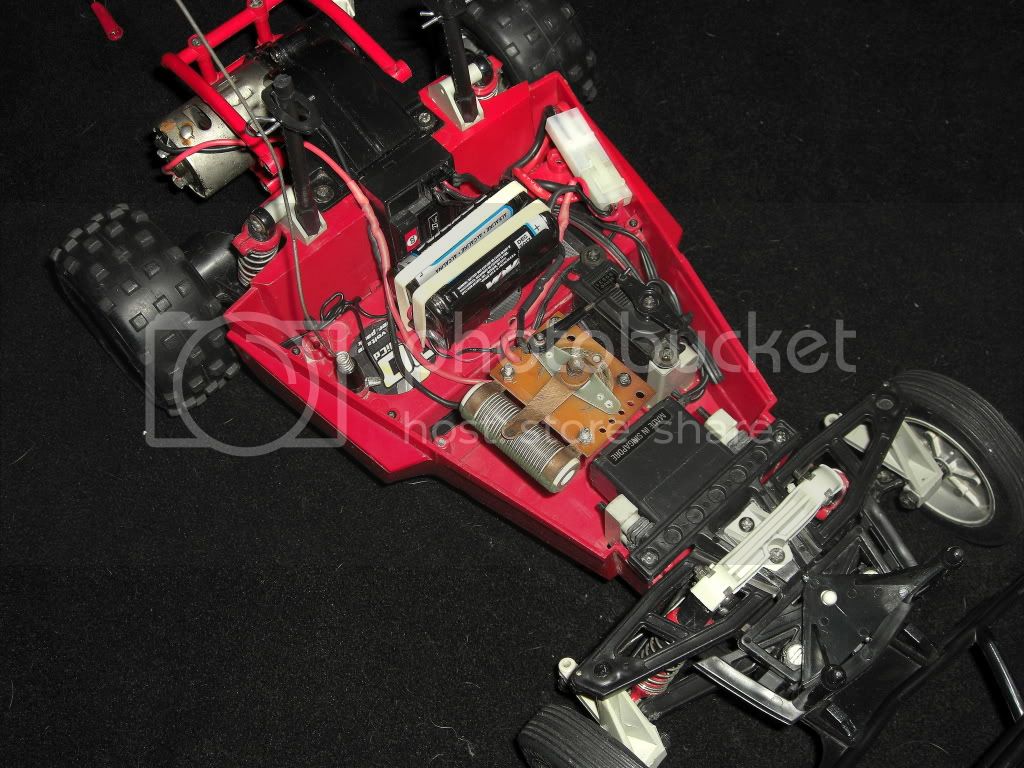

The radio, receiver and steering servo are operational, the auction will provide the speed control (and a mess of spare parts). Aside from dirt/dust collected during layovers in storage the chassic & suspension are in good shape.

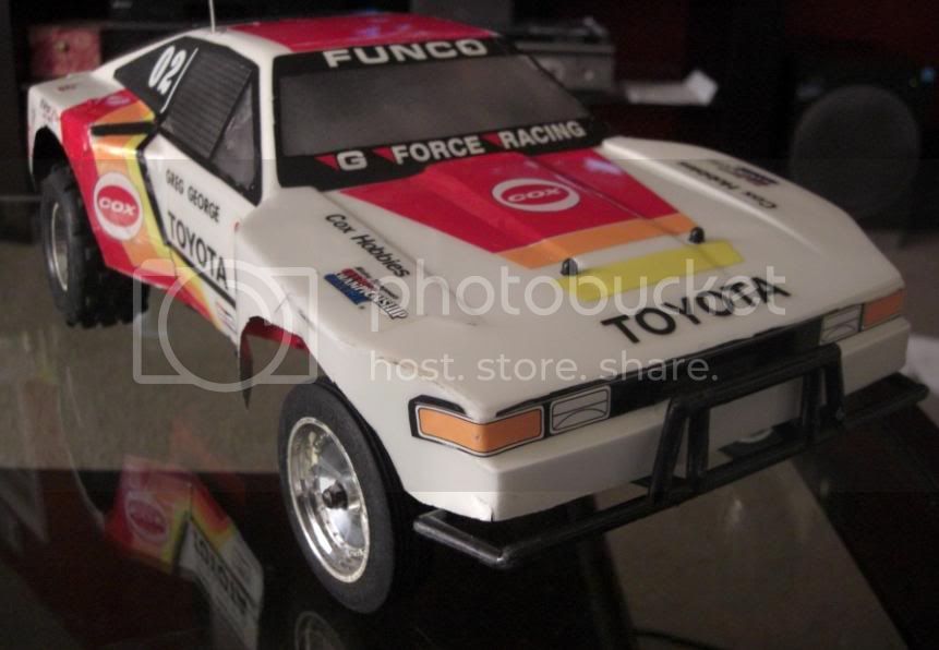

I won the auction which provided the parts needed to piece the speed control back together. Here is the chassis fully 'restored'...
Threw in some batteries and it was ALIVE... Another 20+ year old 'toyota' still tearing it up!:flipoff2:
