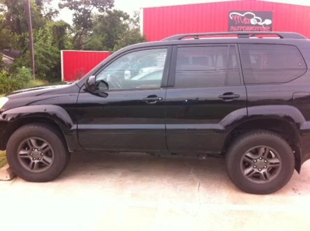

Wanted to post an update. I installed Bilstein 5100 shocks on the front for an fj cruiser. The old man emu springs have settled just a little over the last few weeks and are currently at 36 3/4 inches. However this is with about 125 pounds of extra weight in the back. I only used the 2nd notch on the 5100s because I wanted to keep some rake to it. Right now front is at 35 1/2. I am really liking it so far. No bottoming out at all and soaks up the bumps really well. Wish it was a little but more firm riding but I really cant't complain. I took a before and after photo and will post later.
sorry for the crappy cell phone pics but here it is. First shot is after the OME springs were installed but front is still stock height. Second is after the 5100's were installed in the front on the 2nd notch. Front measurement before lift was 34.5 inches and now is 35.5 inches.

Just lifting the front an 1" makes a noticeable difference to me. I like it, nice job!

Sorry for the slow response. I haven't been on here in a couple of days. I actually used the 2nd from the bottom. It is listed as .85 but I got 1". I was afraid to do the 3rd notch as I wanted to keep some rake to it because I pull my boat with the gx. The front hasn't settled any and I don't think it will. Hope that helps.

Ok. It looks like 21" on the front and 22 1/4" rear. I hope that helps. My tires are 265/70/17 tires which are 1" larger than stock.
Thanks! If it lifts my GX 2" or less I'll be ok. I only have 3" to work with or else my GX won't fit into my garage. :cool:
