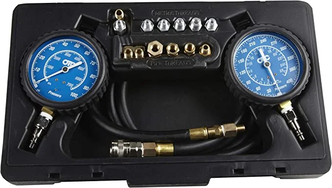

Anyone have a recommendation for a brand of oil pressure test gauge that fits a 40? It’s my understanding that many come with adapters, but want to be sure that whatever I purchase has one that will fit. I’ve read reviews where test kits were missing adapters for a customer’s specific vehicle. Thanks!
Do you mean which mechanical gauges will connect to a 2F where the factory sending unit mounts on the block?
Correct. Wide range of prices and many options out there so rather than throw darts I thought perhaps someone here might be well versed on them and could recommend one. Just trying to determine how far off my dash gauge is vs. reality.

Not a permanent one as a secondary on the dash, but rather a hand held to simply test oil pressure.
1-1/2" Pressure 0-100 psi Mechanical White $45.95 1/8" NPT male (Screws directly to 1/8" NPT female)
4443K835 High Pressure 316 Stainless Tee Right Angle 1/8 BSPP female x 1/8 BSPT male
4092K711 Precision Extreme Pressure 316 Stainless 1/8 NPT Female x 1/8 BSPP Male (Gauge screws directly to this)
4443K806 Straight Connector with Hex Body BSPP Female
SET UP
1. Unscrew existing sending unit from engine block. Sending unit should be 1/8" BSPT male.
2. May need to screw in 1/8 BSPT nipple (which would be male on both ends) to extend working space. Nipples are available in 3/4" and 1-1/2" lengths and are male threads.
3. The 4443K835 Right Angle 1/8 BSPP female x 1/8 BSPT male Tee Fitting may be able to screw directly to engine block
4. The 1/8" BSPT existing sending unit may screw directly into the Female 1/8" BSPT Tee
5. The 4092K711 adapter screws into the other female Tee (1/8 NPT Female x 1/8 BSPP Male) (Gauge screws directly to this)
6. If a Nipple is used, then need straight connector female to female 1/8" BSPT
