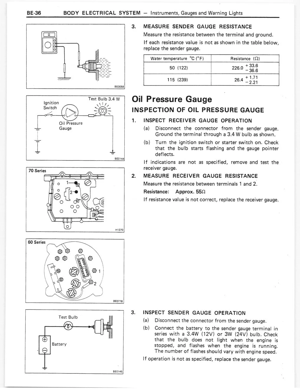

Hello,

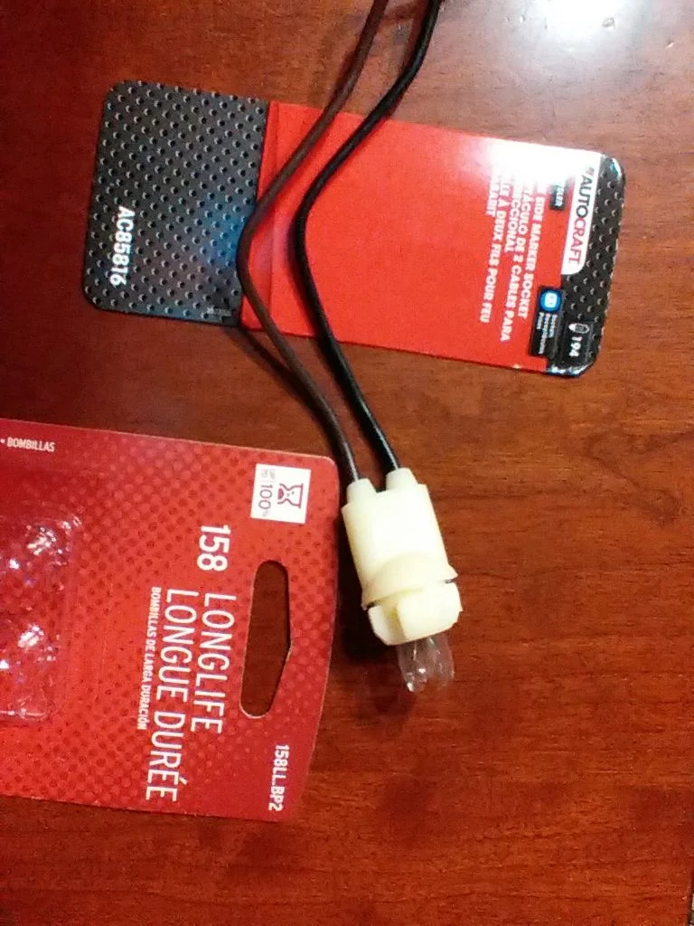

I'm looking for assistance on how to perform the testing for the Oil pressure gauge (1a as seen below)and Pressure Sender (3b) using the 3.4 W bulb that is described in the FSM. How does one create such a bulb tester? Other option for performing this test?
Okay. I think I figured this out. I was probably over thinking it. I bought a bulb socket from advance auto (ac85816) and some 158 incandescent bulbs that are 3.4 watts. I add some clips to the leads.
