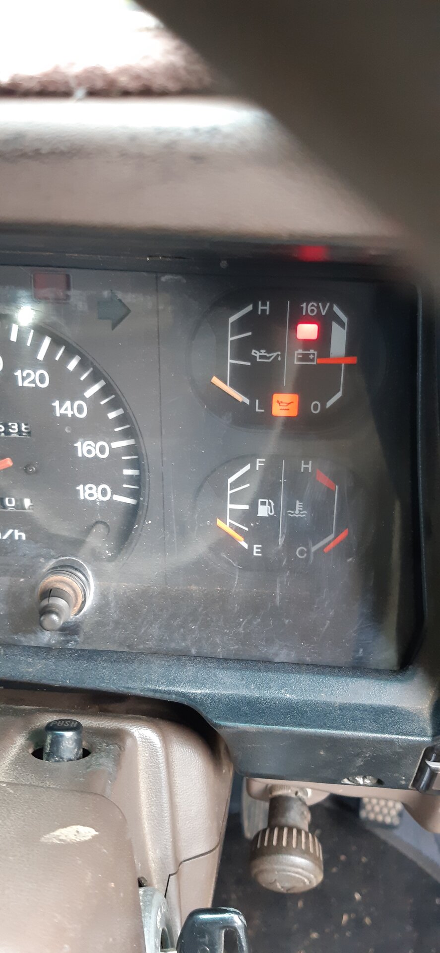

So my oil pressure light has been on for awhile now and I'm just hoping g to find some answers here. So the oil level is slightly above full (from previous owner) and my oil pressure indicator doesn't ever go above the first bar. Could it be a bad pump or could the slightly full oil cuase low oil pressure?
So my oil pressure light has been on for awhile now and I'm just hoping g to find some answers here. So the oil level is slightly above full (from previous owner) and my oil pressure indicator doesn't ever go above the first bar. Could it be a bad pump or could the slightly full oil cuase low oil pressure?View attachment 3322401
Note: my engine isn't running in the photo.

Supposedly, all the oil gauges read a bit low. As you said, mine also stays below the first bar.
I am 99% sure that your gauge needle would be all the way up or all the way down if the sender and/or its wire were short circuited.

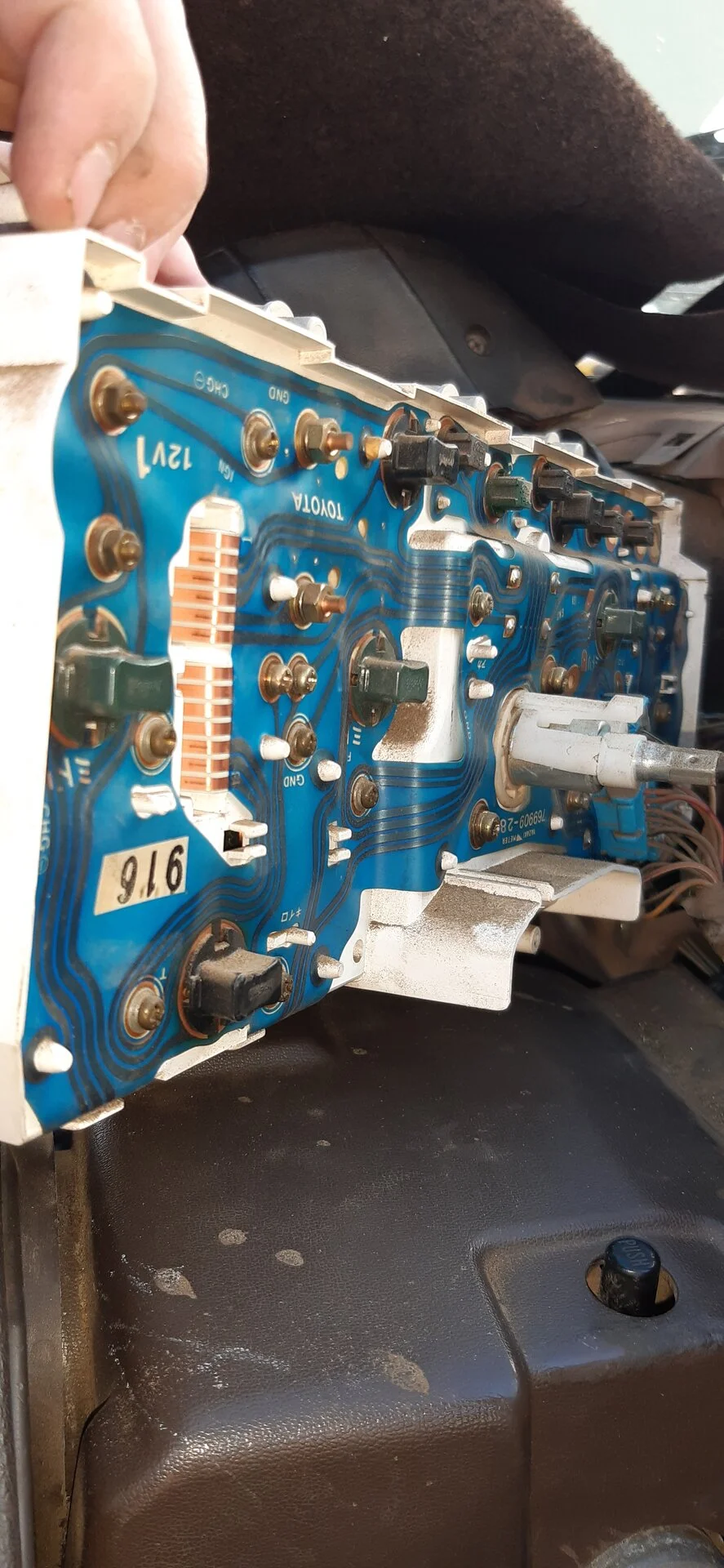

I've just done wjat you said and can't find anything out of the usual. None of the wiring seems snapped the circuit behind the gauge looks normal.

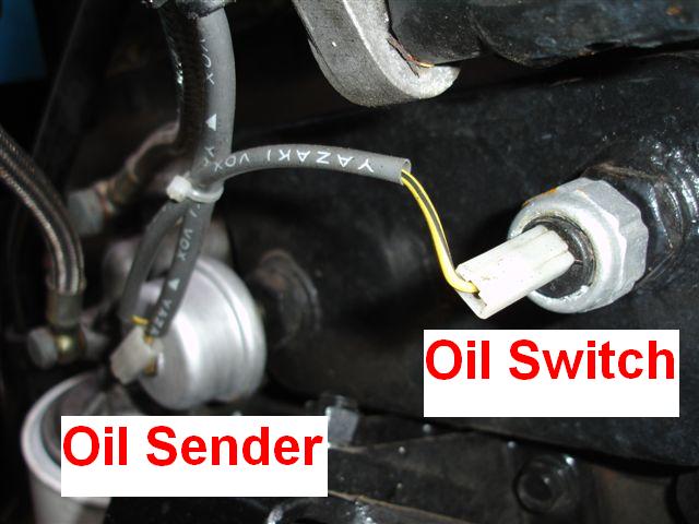

Right, disconnecting the sender would have no effect on that light.
The sender controls the gauge with its needle, the switch is simply connected to the dash light.
The sender is much larger than the switch. the sender is on the right side of the engine on my BJ.
The switch is maybe 25cm in diameter.
If there is wire damage, it is likely in the engine bay.

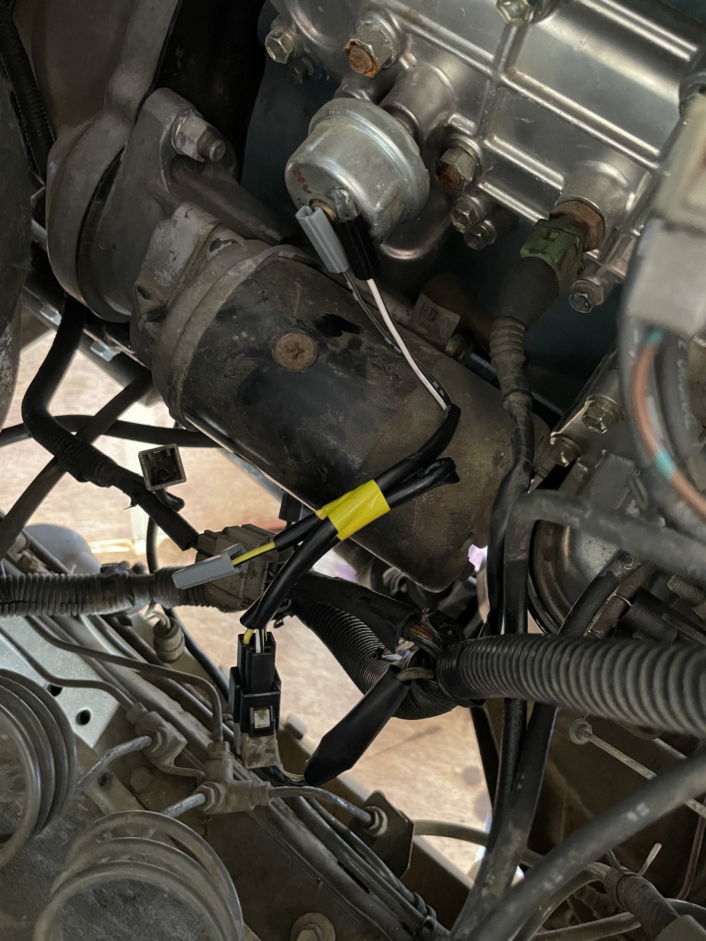

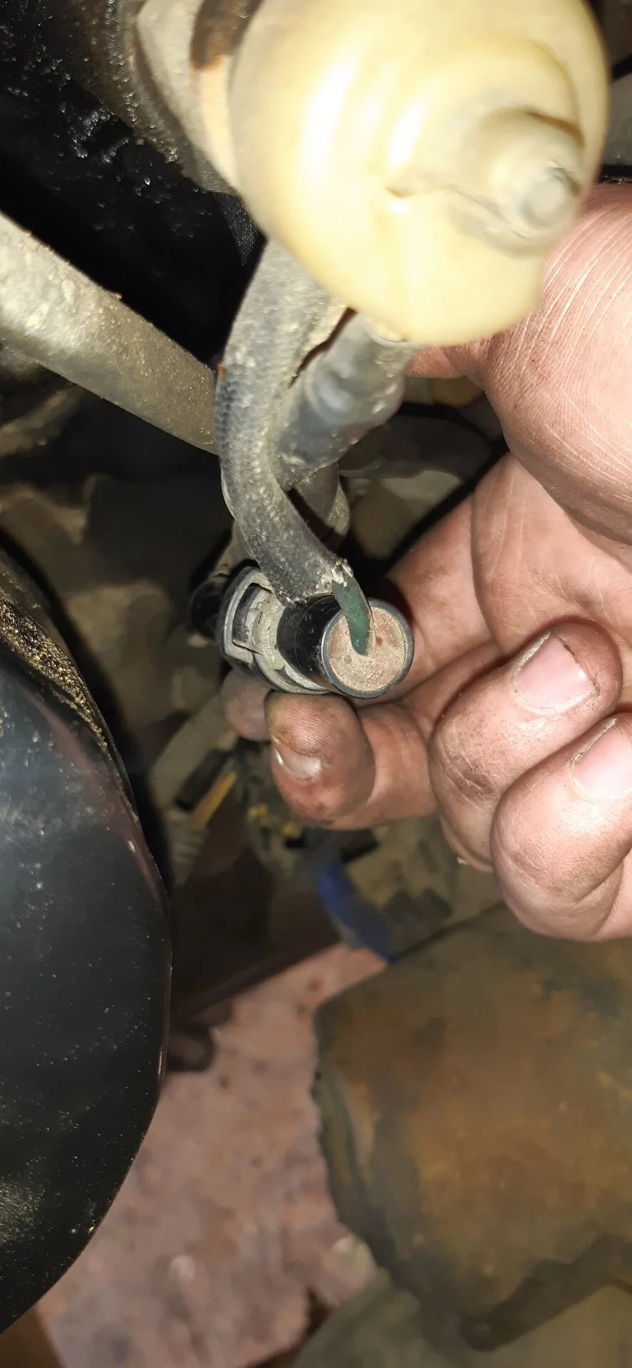

There isn't anything on the left side of the engine as far as I could see. Do you have a description of what the switch would look like? All I could see were these are any the switch you are referring to?

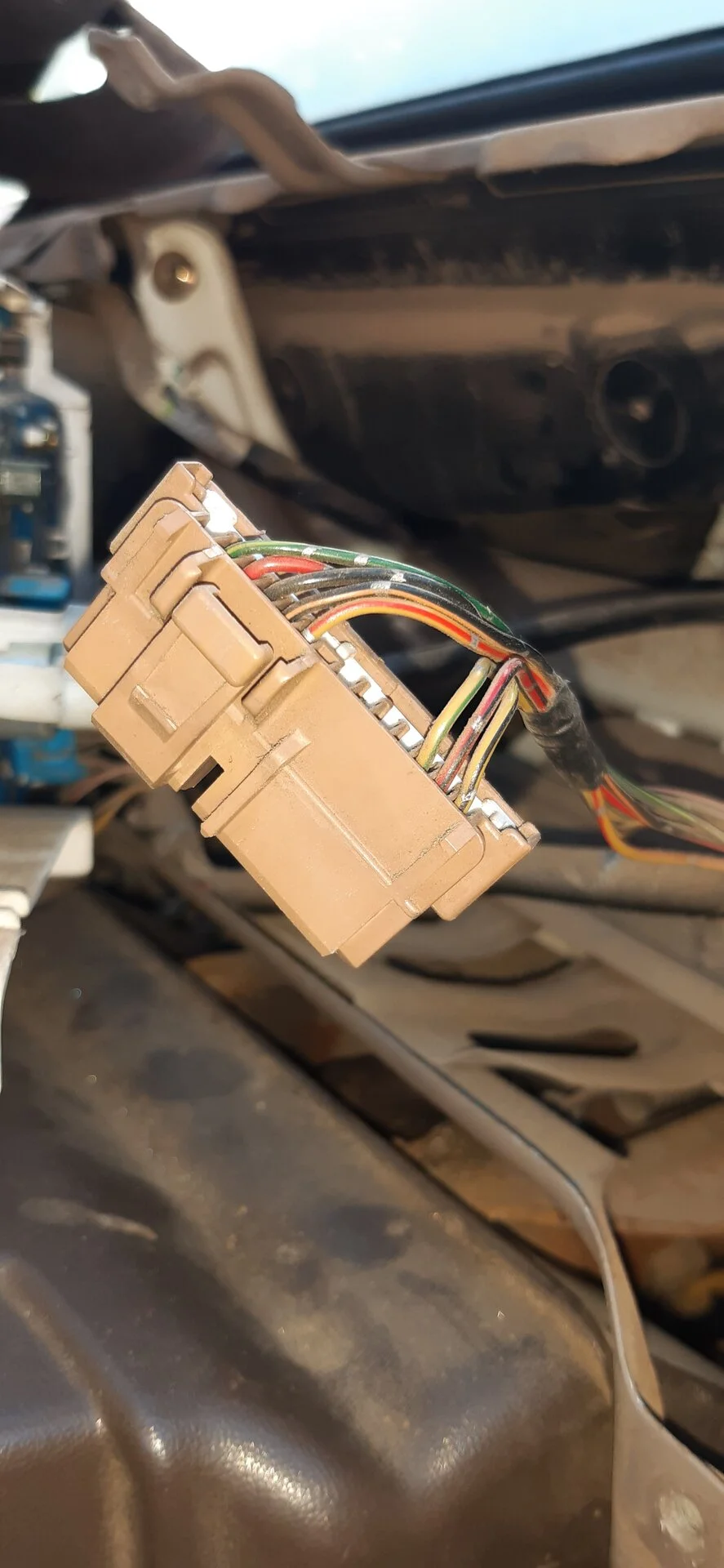

i did not mean pull the cluster like that
just the engine bay BELL SENDER wires ..
but GOOD

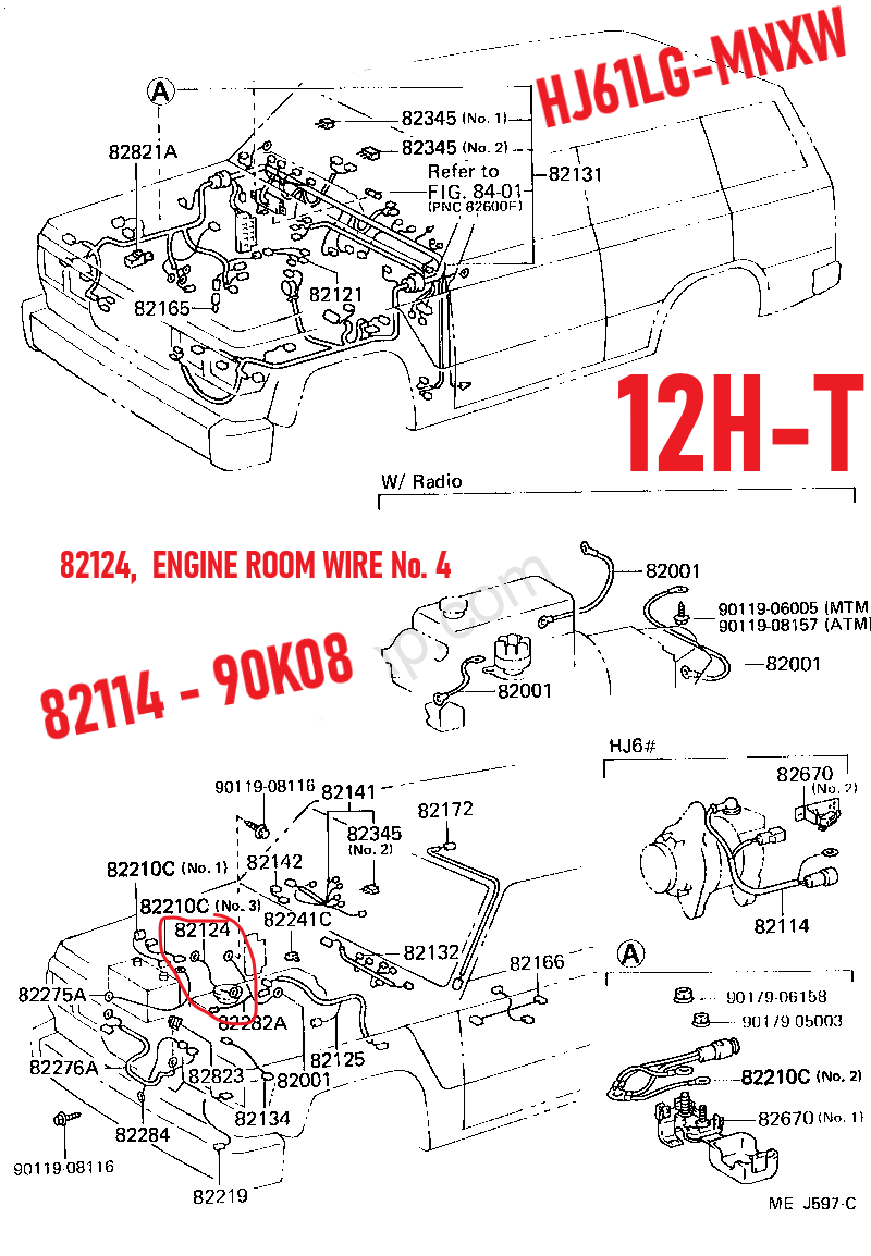

- i have been asked countless times to Reproduce a oil sender and switch SUB HARNESS by the DIESEL Tech folks here
- NO gasoline Land Cruiser engine i know of has both a mechanical sender BELL and a IDIOT LIGHT SWITCH TOO ?
- but many DIESEL LAND CRUISER ones DO , YES

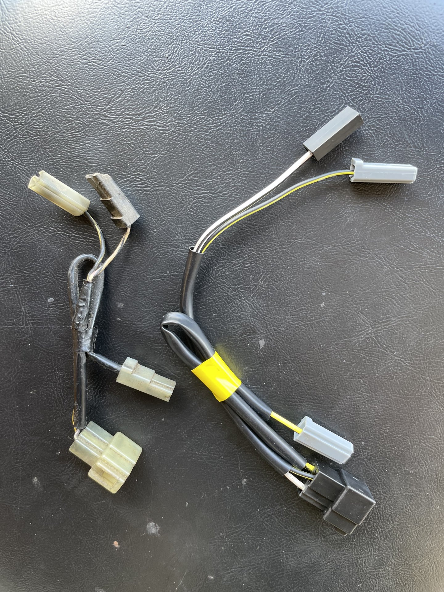

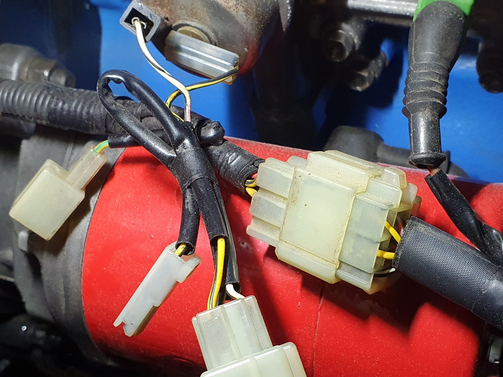

I have TECH pics ,
i do not have 100% of all the facts here on what ones do and do not ?
so , pardon my un-Toyota FSM terminology here also ,
YES i said SENDER AND SWITCH
mr. @jblueridge , would you please fill in the TECH holes on the double oil sender and switch topics and correct any facts i have in error pleas too , thanks :)
below is GOOD tech ,
also the image of the sensor above GREEN plug ?
is this a OIL SWITCH ? i cant say so ?
here is WHY :
TECH TREAD ON THIS TOPIC HERE ALSO :
20210801_191805-jpg.2747438
20210801_210502-jpg.2747519
db4a00d2-d280-4006-9302-b8b304fe445d-jpeg.2780628
34b0fba1-4a53-4f31-a900-0800afb1dc92-jpeg.2775299
cd377225-d765-45a9-a43b-9fc81377ef5b-jpeg.2780629
but GOOD
I have TECH pics ,
- so , pardon my un-Toyota FSM terminology here also ,
here is WHY :

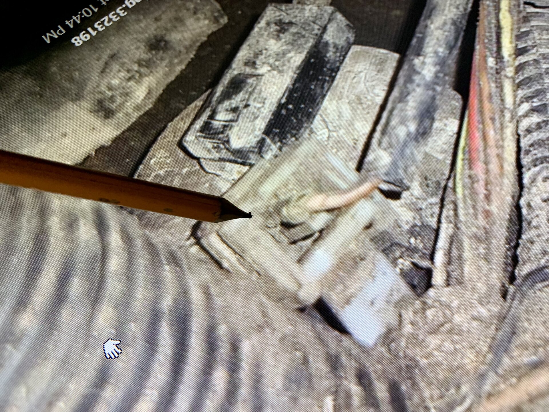

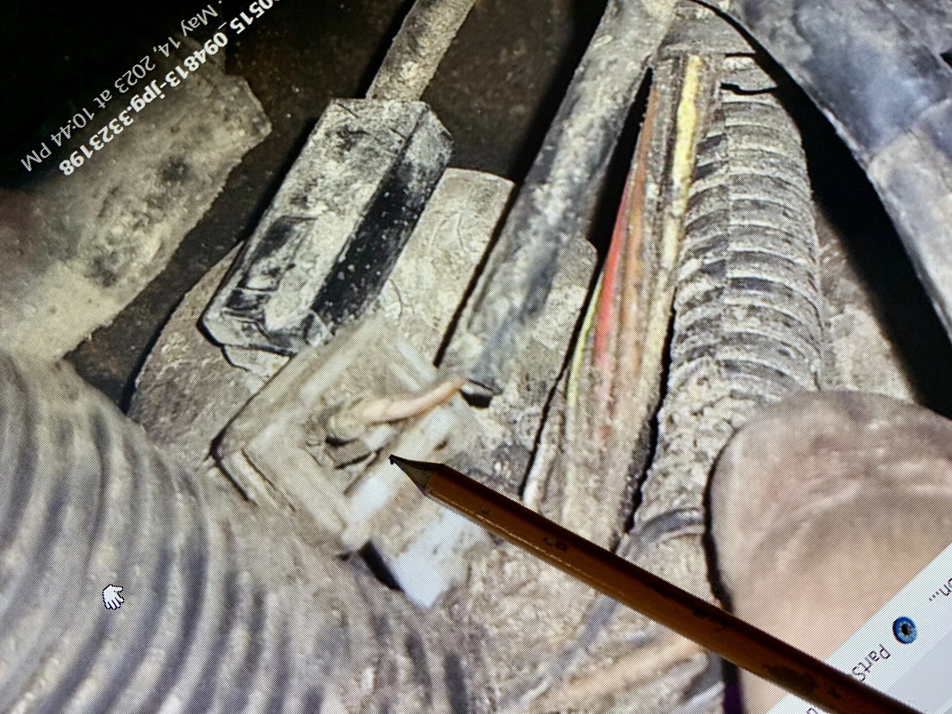

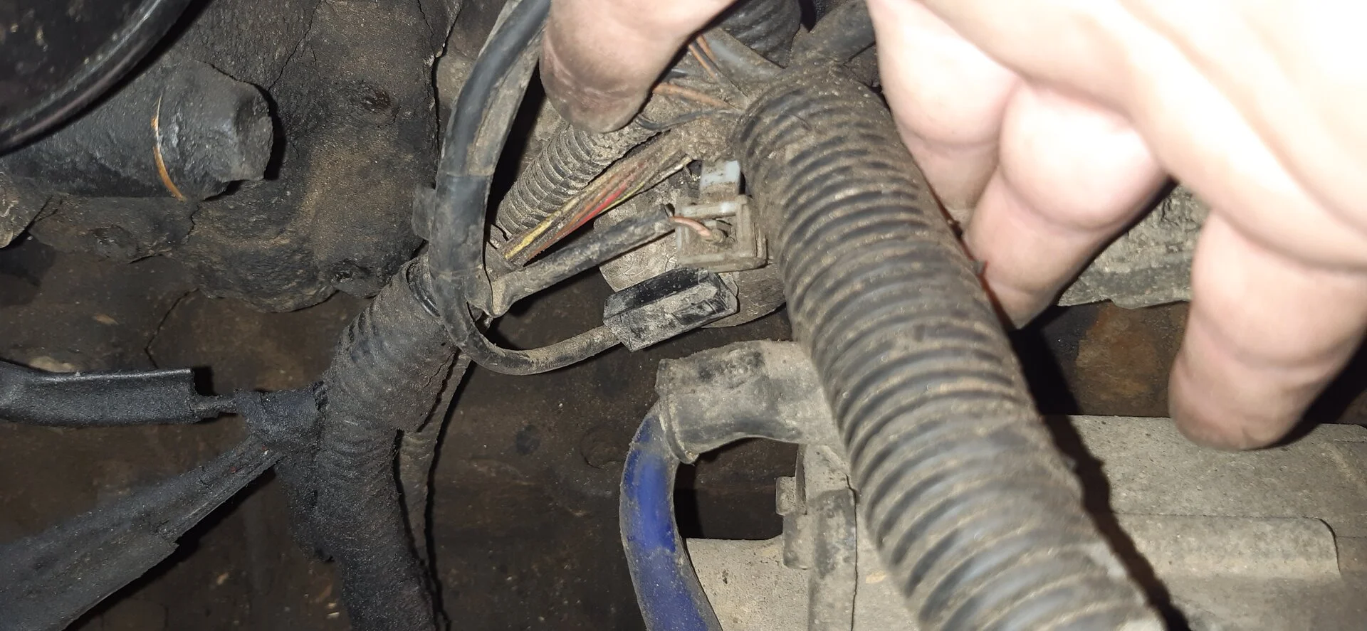

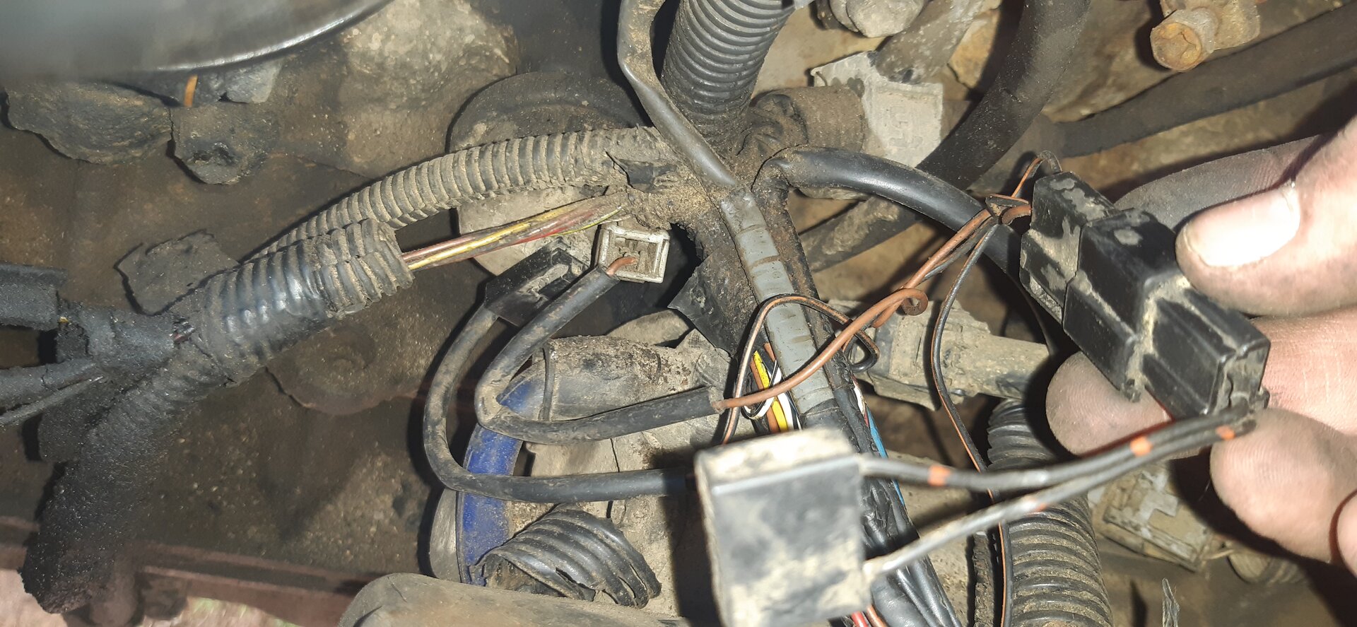

This is the closest thing thing I could find to what you showed me. The lead from the sender intor this "relay" and then a sing wire continues into the wiring harness. I cannot find any switch that connects into the engine like the last picture supplied.
This is the closest thing thing I could find to what you showed me. The lead from the sender intor this "relay" and then a sing wire continues into the wiring harness. I cannot find any switch that connects into the engine like the last picture supplied.View attachment 3323277

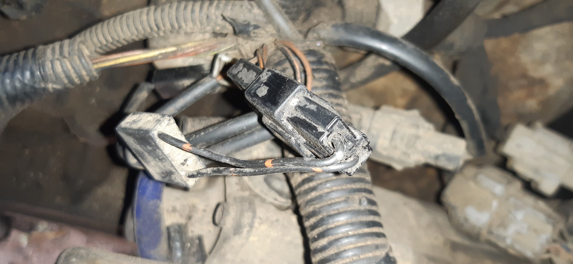

see my pics below
ALL that Corrosion and dirt mud and crap in those connector plugs CAN be your problem ?
CAN ?
clean them up and make good solid electrical BRASS ON BRASS contact here
this a RED FLAG to me ...⛳
Do only 1 Connetor a time
Do NOT pull both off same time
Fyi
The grunge here is NoT Normal
Toyodiy.com shows that engine should have an oil pressure sender and an oil level sensor.
It also shows that engine does not have and oil pressure switch.
I think you should also post on the Diesel and 24V section and search for the oil level sensor.
I found a pic of the oil level sensor.
It looks like it has 4 or 5 bolts and a white plastic socket for the wiring to plug into.
Probably bolted on the side of the engine with just the socket sticking out.
