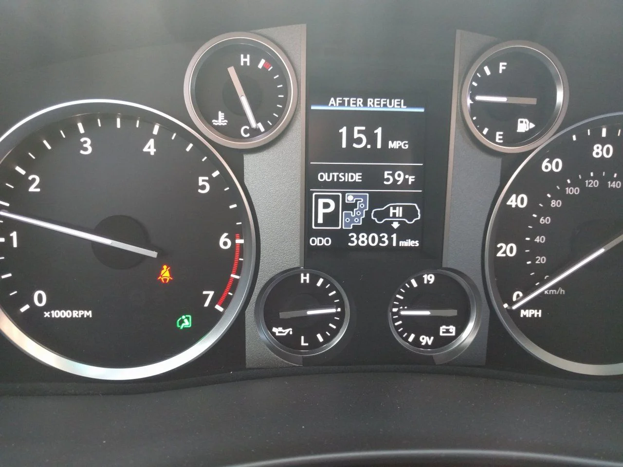

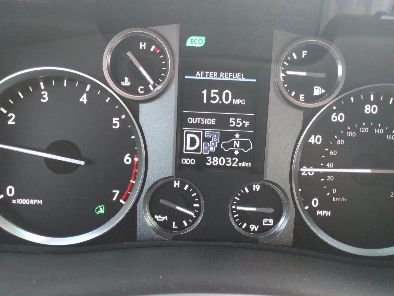

Maybe we need a PHOTO of several "normal" gauges, as this question comes up every month or two. :)
I don't think we need photos but, this is just simple fluid dynamics. Engine oil is in a high viscous state when cold and less viscous state when hot. higher pressure is required to push the high viscous oil vs. low pressure for less viscous oil.
What I meant to type was... Would be nice to have a photo on the FAQ page....so people could see that it's normal.
No...we don't need a photo here, but the question comes up so often that it might help to have a photo of the gauge that says, "Yes...this is normal." :)
