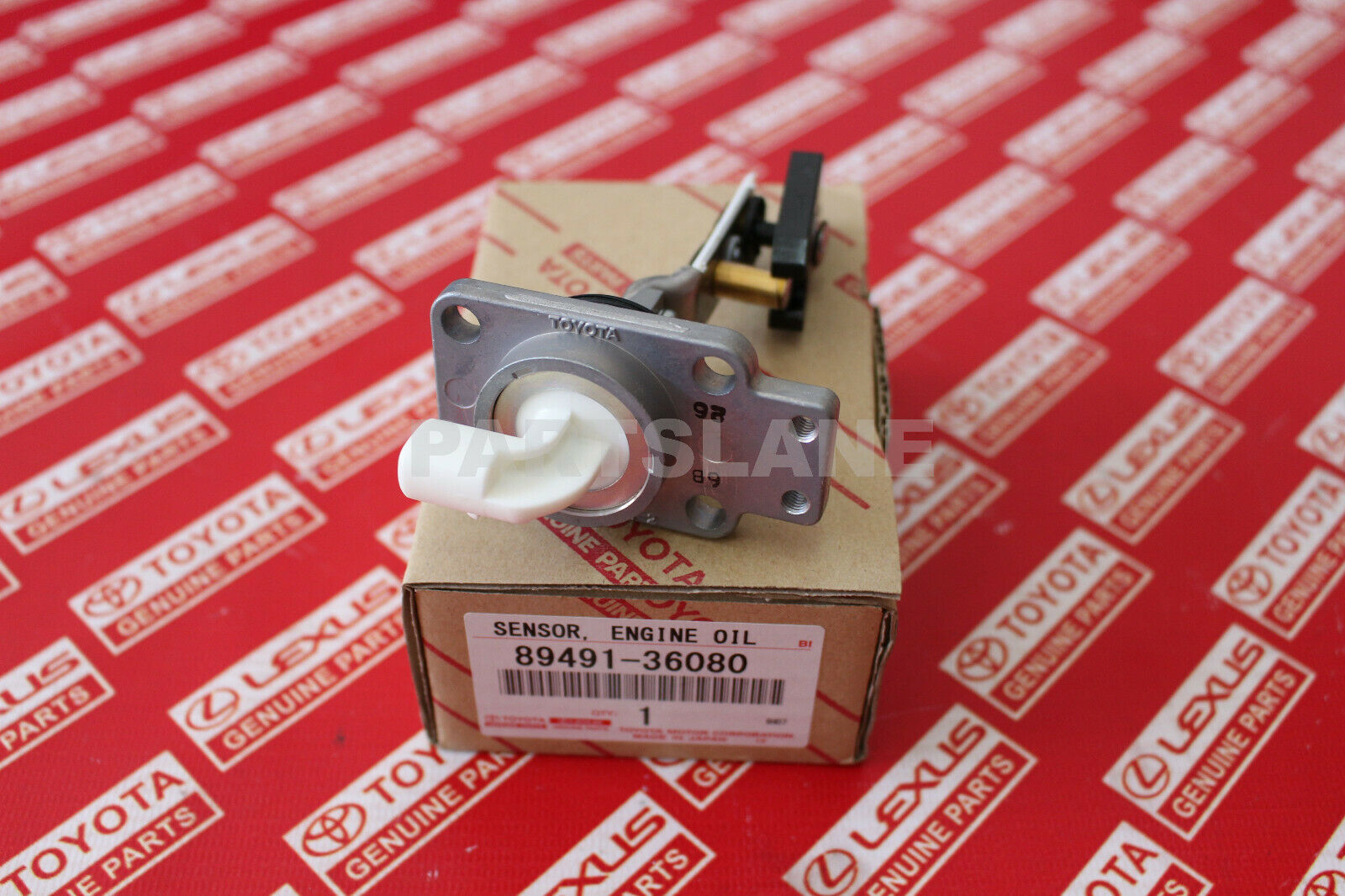

Hey everyone! Need to replace my oil pan. Has some pretty bad rust. It's a 1991 1HZ. The original part number is 12101-17030, which covered 1/1990 - 8/1992. The replacement for that is 12101-17100, which is supposed to cover up to 5/1993. So I've been searching online for the part, just to get an estimate of price before I go to my parts guy in Okinawa. The images that return when I search the part number show a hole in one side with 4 threaded bolt holes that appears to be intended to mount something. The problem is, my cruiser doesnt have a corresponding hole. Do I have the right part number? Is there an additional part I'm missing that I need to use to block this hole? Is there some sensor from newer models I need to install and leave disconnected? Thanks in advance for the help!
I believe it's for an oil level sensor.....
Image result for 89491-36080
So if it is the oil sensor, is there an alternative to installing it? Like a blocking plate? I dont have an oil level sensor on the truck. Pressure sensor yes....but its internal.
