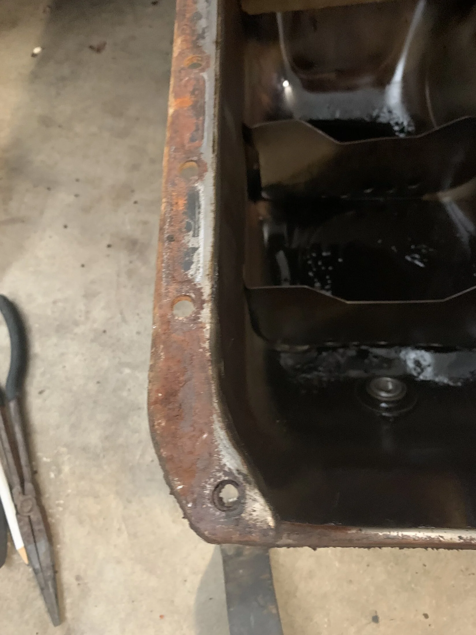

Got the pan off! Minimal rust/scale in oil.
Cleaning pan in prep for media blasting.
