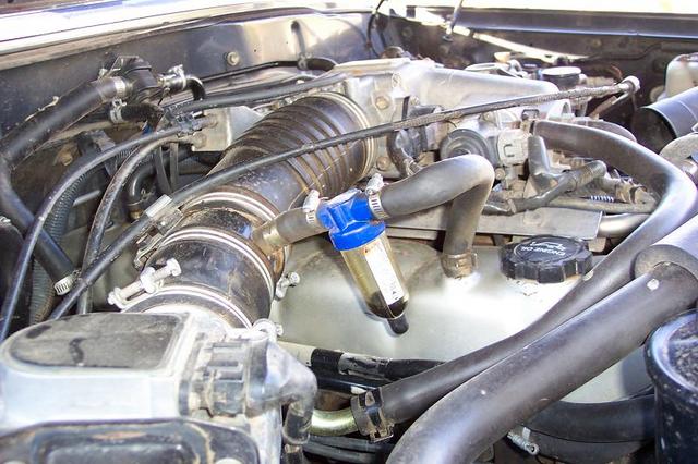

Knowing now its gone this is sorta moot....But heres what I have done. I change the filter bottle every once in a while-but my intake and hose are CLEEEAAAAN after 35K miles. That and I change my PCV valve at regular intervals.
Kinda embarrased about the dusty engine bay-been running alot out in the field for work lately...
Rich said:
Oil in intake is due to bad pcv valve.
Is the PCV the only source of oil in the intake hose between the air filter and the intake manifold? My 3FE has two hoses coming from the valve cover to the intake. One is comes from the rear of the valve cover, ~ over the #6 cylinder, and appears to have the PCV valve. The other comes directly from the valve cover, ~ over the #2or3 cylinder, and doesn't seem to have a check valve of any sort, PCV or otherwise, and goes directly into the intake hose, as shown with the blue separator pictured above. What is the function of this second, non-PCV hose? :confused: It seems to be the main suspect in oiling up my intake hose.
