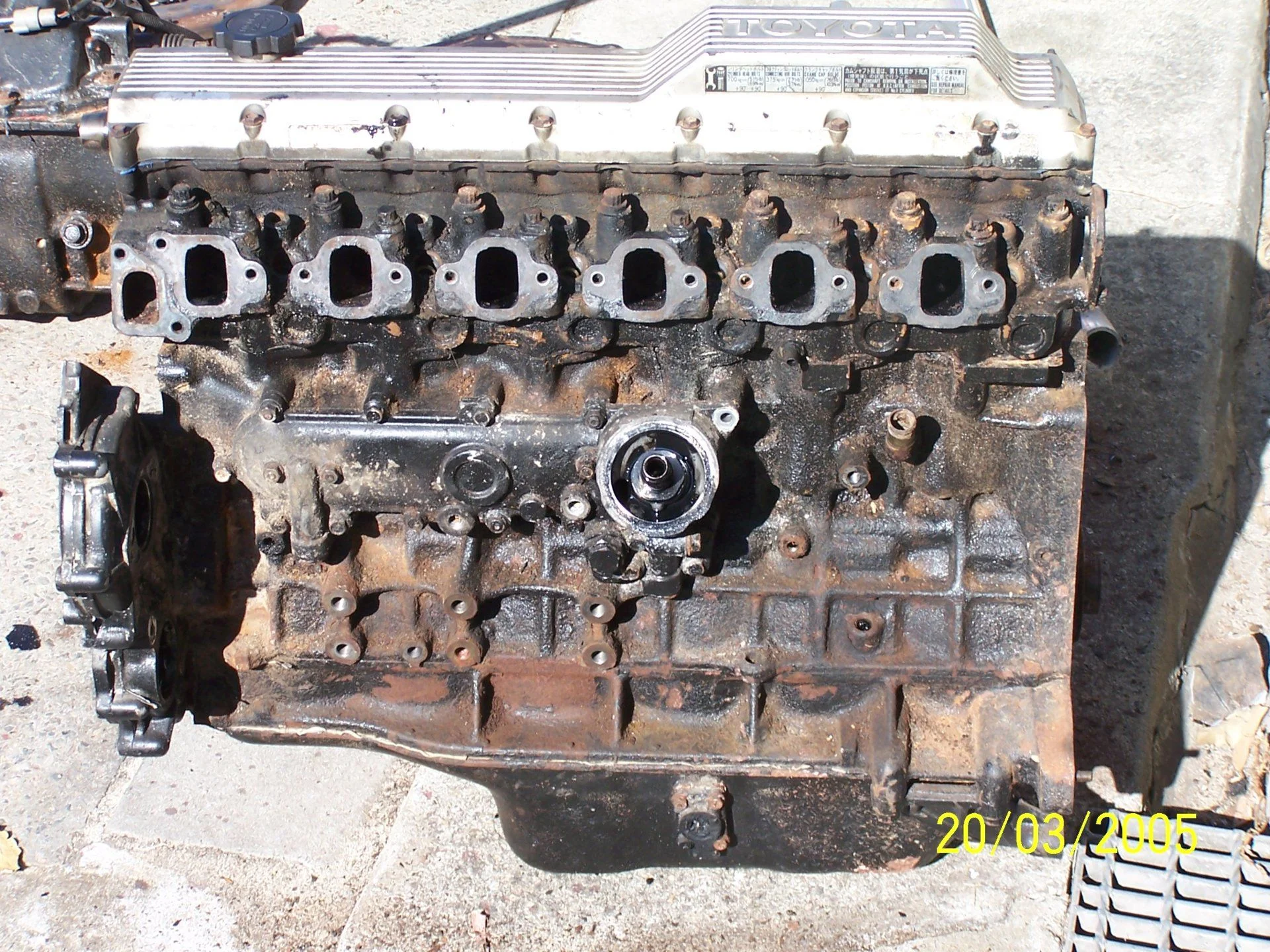

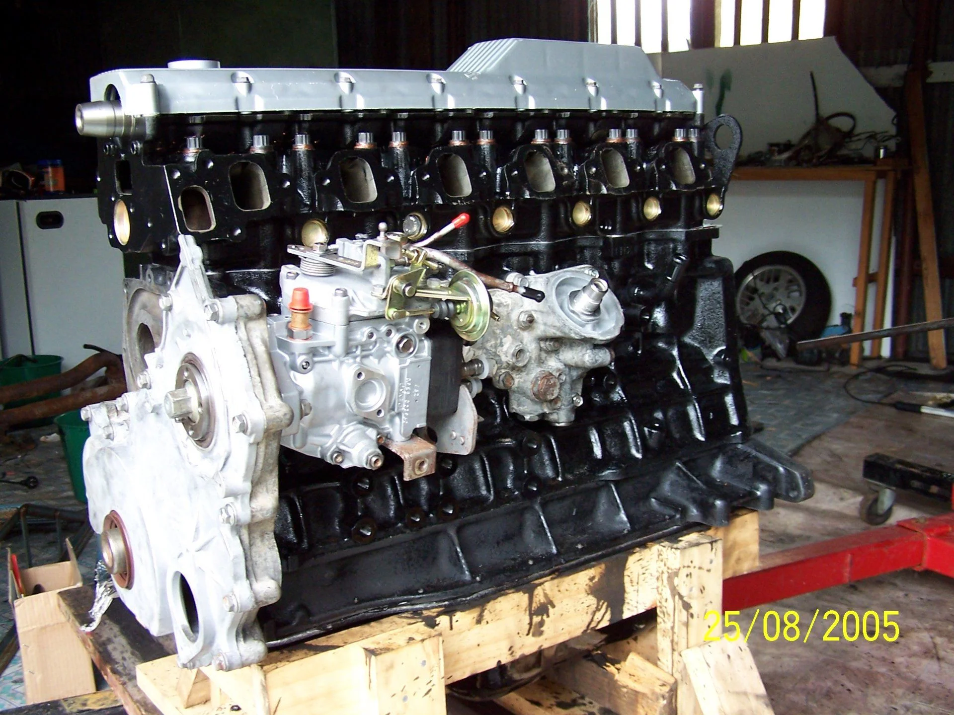

Thanks... you've boosted my confidence ..guess...all can do is try n see.The lesser the evil the better...cheers
Its those 3-4 bolts along the bottom of the cooler that look difficult. You could get underneath and just see if you can reach them with a spanner.
Yea will be tricky ...moreso is once covers undone and with the cooler attached can it be withdrawn past the injector pipes (...wishing not to seperate cooler ) thank you
Oh yes, it may have to come out an inch or 2 because of the cooling pipes. Im starting to think you should be looking for a good puller
