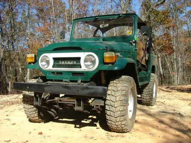

Mine still has orginal paint and it is in decent condition. A repaint is due this spring funds and time willing. I am not sure of the color code, perhaps someone more wise can give the specs... I have always called it smurf blue, or homosexual blue... but I doubt Toyota called it that.
