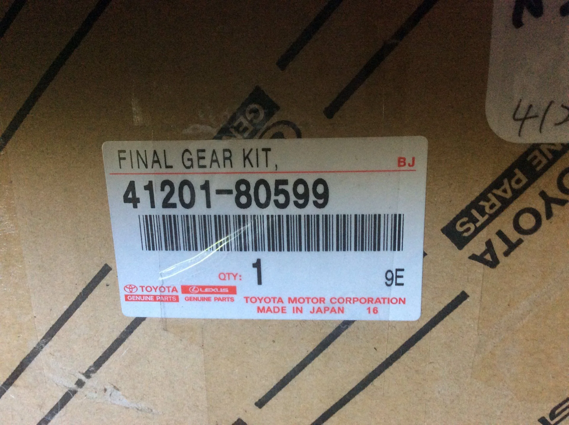

They exist! Late model 4.88 gear sets for the rear axle. A set is on the way from Japan... should be interesting. Part number for the 2007 - 2015 is 41201-80495, 2016 and up is 41201-80599. Not quite sure what has changed or if the older number will supersede to the newer, but the later 80599 has been ordered, and I will compare it to the factory 2009 gears that are here.

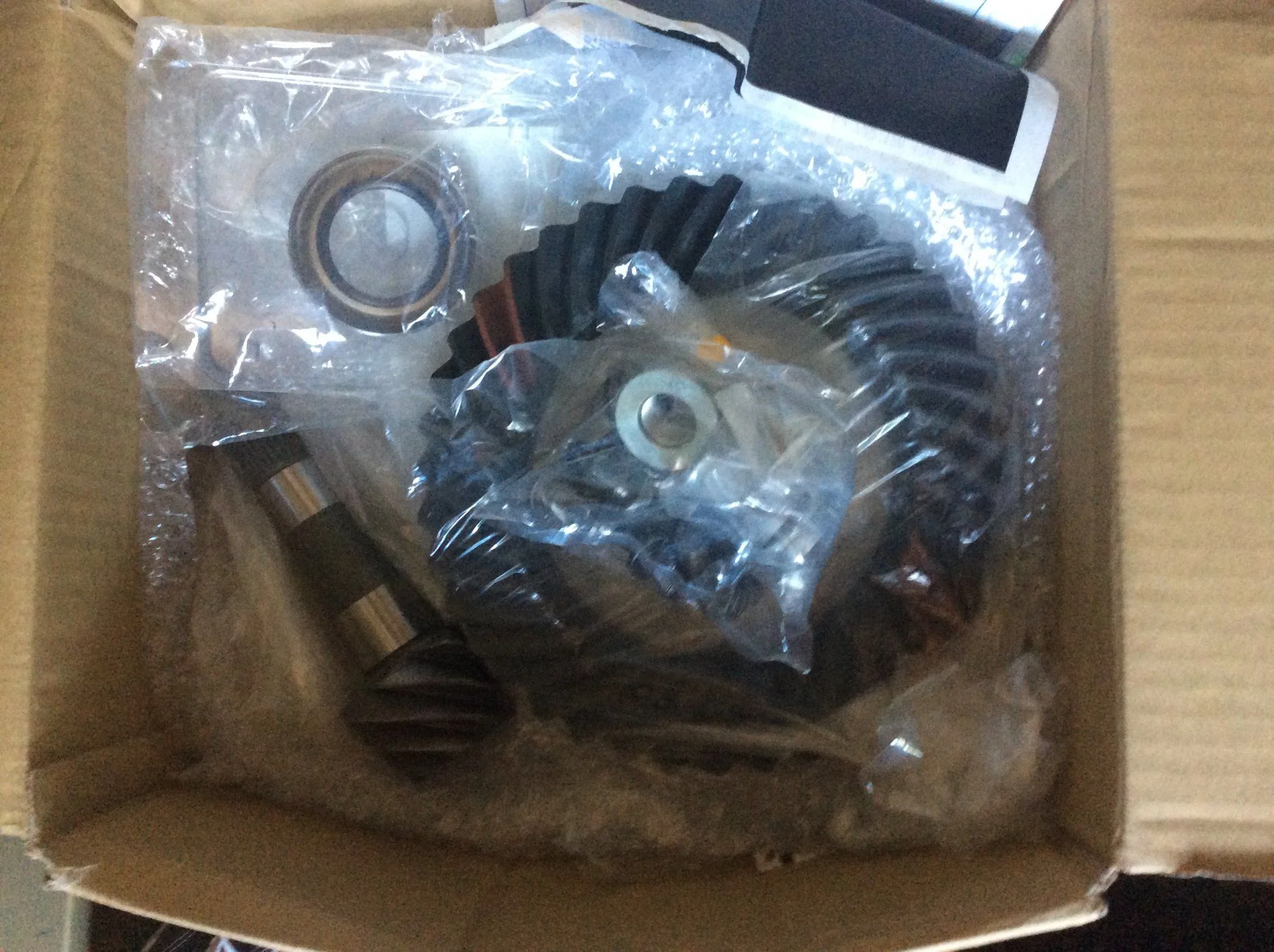

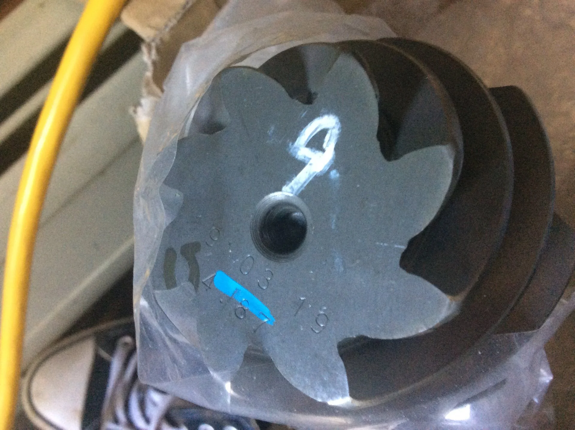

Physical proof. Toyota gears come with a minor install kit... ring gear bolts, crush sleeve, pinion nut, and seal.
