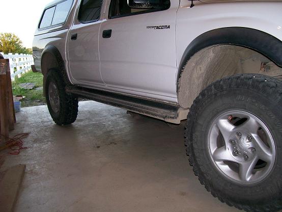

Removed OEM step this weekend in preparation for the Trail Gear Sliders installation as soon as my :princess:-do's are completed.
Notice in the pictures it appears that I have already gained about 2" more clearance just by taking off the step but now the rocker panel is naked & vulnerable to damage.
Better get to work so I can show the finished product! :D
Definite improvement....even without the sliders.....

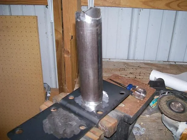

I had to cut to length the notched tubes that run from the frame bracket to the slider.
Now it is time to clean up the mounting plate (grind off the slag & oil) and the tube ends to be welded.
2nd pic shows finished one side of mounts

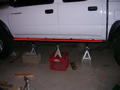

3rd picture is leveling the frame rail, I used my floor jack so that I could use this as a point of reference to make sure that the sliders were in line with the frame.

After I decided where the mounts could fit, around other considerations on the frame, I located where I would have to clerance the pinch weld for the mounts.
This happened because I welded my mounting tubes too high up on the mounting plate. Measure twice & weld once! :D
It gained me another 1" clerance but cost me a lot of work grinding out the pinch weld! :bang:

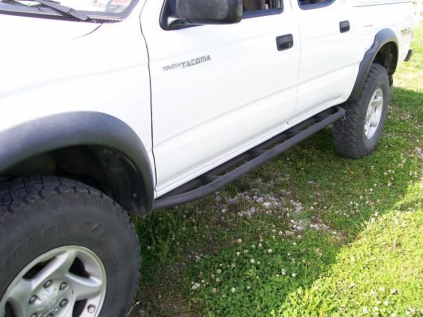

Here is the final product
Thanks for looking :D
I will test them this weekend with my Hi-LIft to see that I can lift my truck with my welds....you'll just have to check back :popcorn:
