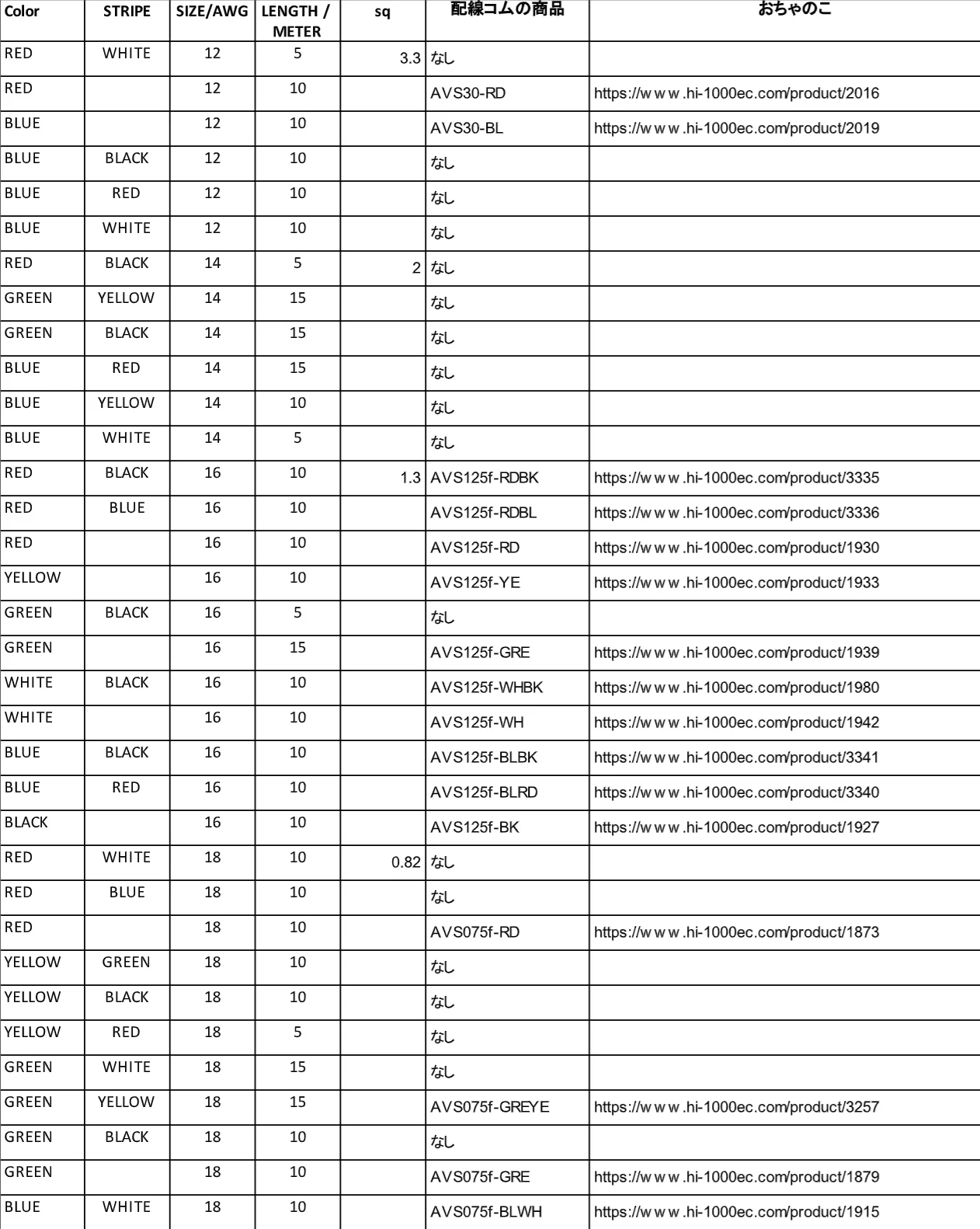

Hey Guys,
Looking to buy some Electrical cable to match Toyota with all the good colors and rebuild my wire floor #2 & main wire floor
I have been referring to this site for some electrical cable but unfortunately, they don't have all of the colors required I counted more than 35 in my harness
hi-1000ec.com - https://www.hi-1000ec.com/
Most of the electrical cables are 1.3MM but the site states Standard size 0.3(f) flexible constitution equivalent Finish outer diameter (mm) 1.5-1.7
They also sell the male & female connectors : ■[Yazaki] 040 Type M terminal Nonwaterproof / M040 - https://www.hi-1000ec.com/product/1257
Looking forward to some guidance as I have not been able to locate a new harness...
