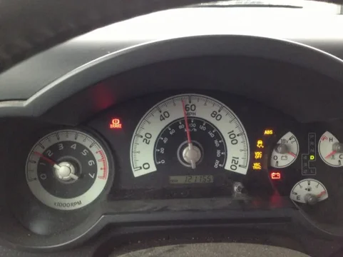

Soon after we left our dash started lighting up.
The ATRAC, TRAC, etc tree first lit up. Then it started raining so the lights and wipers were turned on. Soon after the brake light came on. Turning the lights off made the brake light go off for a few minutes but then it came back on.

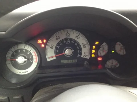

We pulled into the house and the dash looked like this. I think my FJ is trying to tell me something. Now the airbag and open door lights are on.
As a test I cut the truck off and tried to restart - not even a click.
I have a couple extra batteries in the garage so I'm going to switch the low one out and head to the shop in the morning.
